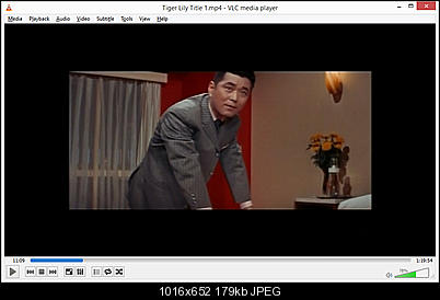

  1. I've got a DVD of Whats Up Tiger Lily which is in the format shown.
Name:	Tiger Lily Screen.jpg
    I've tried to back it up as an avi file, using Freemake Video Converter and played around with the settings, but I always end up with the action surrounded by a black band. Any ideas how I can re code so I get a full screen picture.

  2. MP4 isn't DVD so this video's history is a bit more complicated than you're letting on. What is your source? How do you intend to view it?
    FWIW that film is in TohoScope, so the proper aspect ratio is ~2.35:1. How to manage that depends on your answers to the questions above.

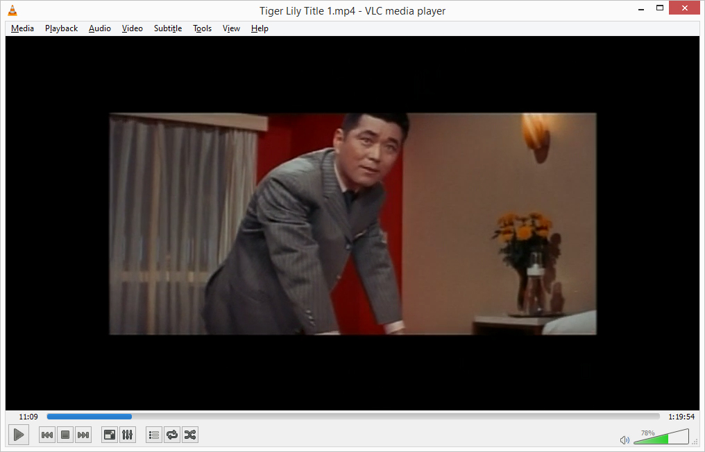

  4. I've had a look at the DVD and cover and they do appear to be genuine.
    Here is a screen shot of what media info reports.
  5. It's a 4:3 file, meaning the upper and lower black bars are hard coded in. You're adding the side ones with your encoding to 16:9. You want to use a tool that will crop off the top and bottom bars and re-encode to mp4 with square pixels. Try handbrake or MEGui.

  11. Keep in mind that DVDs come in only two display aspect ratios, 4:3 and 16:9. When the content doesn't match the DVD's DAR black bars are added to fill out the frame. In your case you have a ~2.35:1 movie in a 4:3 DAR DVD. Crop the black bars and resize what's left to a 2.35:1 frames size like 704x300. Or crop the black bars and encode without any resizing and set the SAR flag to 12:11.
    Thank you very much for all your help. I've done a re-encode using Handbrake and all seems as it should be. I was born before D-Day, and although I think I'm pretty good for my age, I do need a helping hand now and then, and its people like you who get me through any problems I come up against. There is something to be said for keeping on working past retirement age. It keeps the brain reasonably sharp.
