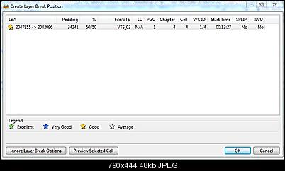

    Ok, I opened the video ts folder in imgburn, and this is what came up:
    This is a full DVD with less than 20MB free space, so I guess it makes sense that there's only one option for the layer break?
    Be thankful ImgBurn gave you a choice. Take that. After selecting, preview the break, check seamless, burn.
