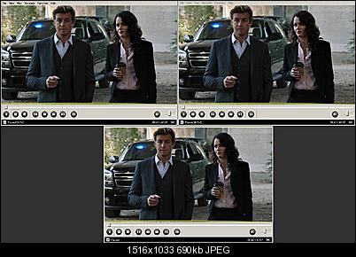

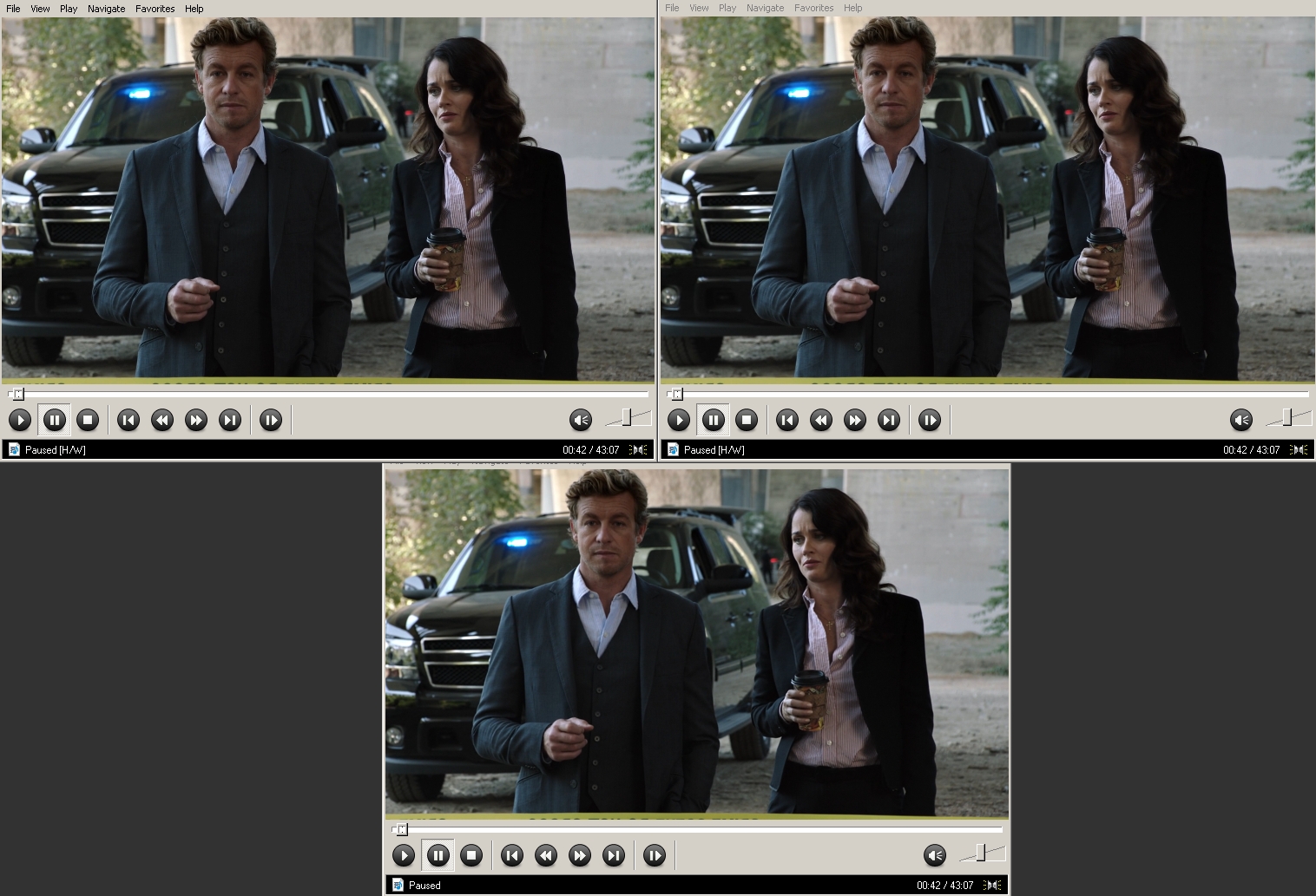

  5. Well I'll confess if there's a difference between renderers I'm struggling to see it. I put some black on the screen and played with the brightness and black seemed to be black at the same point for each renderer. If there's differences, I don't know how to look for them, or they're pretty subtle.
    I'm not sure if screenshots would really prove much, but here's what I'm seeing. The Nvidia drivers are set to expand the levels.
    VMR9 on the left, EVR on the right, and MadVR on the bottom. They're stacked that way so I could resize all three to fit on the TV at the same time and compare them side by side. Even when I maximise all three on the TV and switch between them that way I can't tell them apart. Well..... MadVR obviously resizes differently because fullscreen (the video is 720p) I can see it's a fraction sharper, but that's an upscaling thing. The levels and colours look the same to me.

    I'd trust MadVR. I'm sure if you open each version with it you'll find the original, Adobe and Handbrake versions all look the same. The MeGUI/Avidemux version should look darker than the original because it's levels weren't converted to limited range when encoding. Therefore Adobe and Handbrake are getting it right.
    The way it works for me is if I open the original video using MeGUI and compare the preview to the original video being displayed using MadVR, the MeGUI preview looks darker.
    After adding the conversion to the script:
    ColorYUV(Levels="PC->TV")
    MeGUI's preview looks the same as the original (MadVR).
    When the video is encoded with the conversion in the script, the encoded version has limited levels. Display the encode using MadVR and it'll expand the levels (correctly) and it'll still look the same as the original.
    Having said all that, there's different ways to convert the levels (it's another story). The method I described earlier may produce a slightly different result on some videos, because it limits the luminance range.

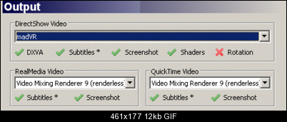

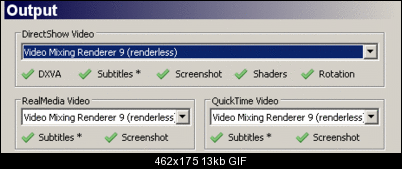

    Even though I've been to the MPC-HC settings page at least half a dozen times today, I forgot MPC-HC had a separate option for QuickTime video. So I guess I don't quite understand how that works.
    Why do these two configurations give me different levels when playing the original mov file (VMR9 is darker with the video card set to expand the levels) given the Quicktime video setting remains unchanged? I don't have anything Quicktime/Apple installed. What exactly would the definition of "Quicktime video" be?

  13. Yes, have a look at handbrake's log file there might be some clues as to what it's doing behind the scenes. Adobe doesn't adjust levels unless you tell it to, so it's decoding at standard range (and there is no funky YUV<=>RGB business going on, because PP CC is able to work in YUV natively)
    I'm not sure how MPCHC handles that renderer choice internally for QT vs. DirectShow . You could ask one of the developers. But before the Renderer choice, the internal configuration matters - ie. what splitter and decoder is being used for MOV files. If you don't have anything Apple/QT installed, likely it's set to use the internal configuration. But if you see the lav icons or ffdshow icons pop up when you play the video, that tells you what decoder is being used (not the internal MPCHC configuration, but the system installed directshow decoder)
    The definition of "Quicktime Video" is anything MOV wrapped
    Also when you apply changes, make sure you close MPCHC (or any video player) and restart it before checking
