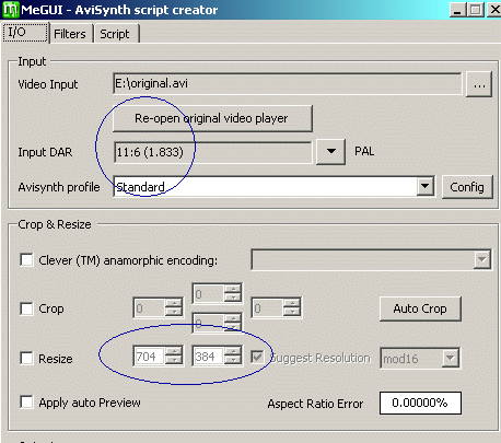

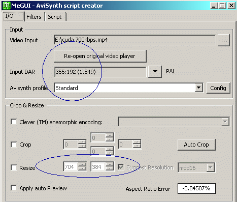

  7. Originally Posted by deadrats View Post
    my first post explained repeatedly that the aspect ratio did not change, just how it was represented, as a fraction rather than a decimal and i showed you the simple math that proved that.
    If that's the case you're just plain wrong, and I guess I wrongly assumed you were clever enough to see the aspect ratio had actually changed and you weren't frantically trying to deny it.
    The original AVI was 704x384 with square pixels. The encoded version was 704x384 with an aspect ratio of 355:192. It's a different aspect ratio, plain and simple. I posted screenshots to prove it, and they show the aspect ratio is different, not that it's being displayed as a "rounded fraction" or whatever imaginings you're having.
    The encoded samples I previously uploaded have a different aspect ratio to the original AVI. If you've checked them but you're too clueless to realise that, then I guess that's your problem. You've only got to open the original video and one of the encodes at the same time to see the display widths are slightly different.

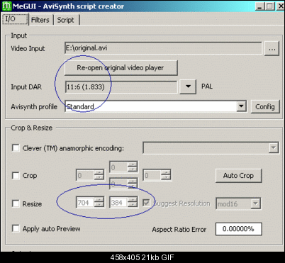

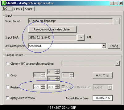

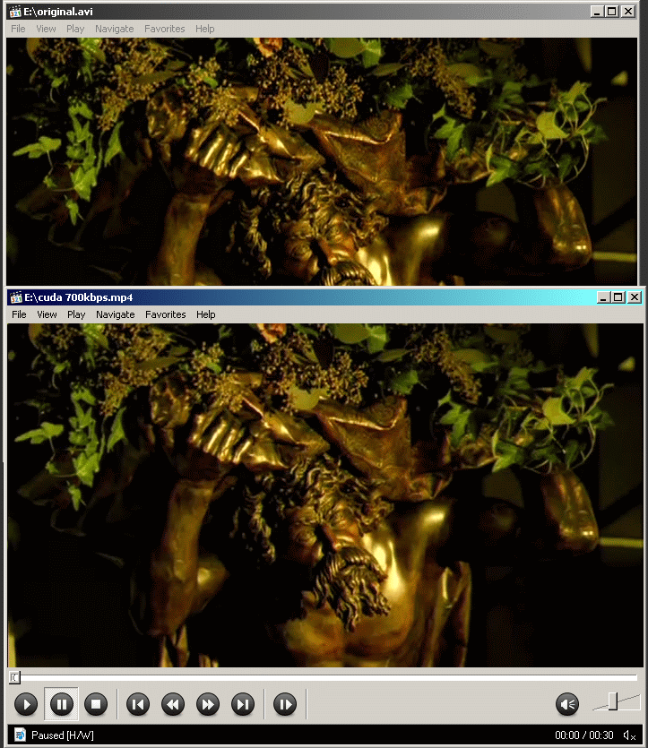

    yet you still cling to the belief that media coder somehow messed up the aspect ratio
    It did. I've re-run the same encode using the same "keep display aspect ratio" settings several times and each time the input aspect ratio was 704x384 (1.833333) while the output aspect ratio was 355:192 (1.8489). CUDA or x264, the result was the same. I don't know how else to explain it. Maybe a couple more pictures might cause the penny to drop given a written explanation seems too much for you to take in. They show the aspect ratios are different exactly as my original screenshots do, even though you're still in some state of serious denial there.
    MeGUI displaying the aspect ratio of the original AVI.
    MeGUI displaying the aspect ratio of the MediaCoder re-encode. The same samples I uploaded (post #33) so you can check them again for yourself.

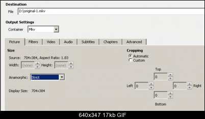

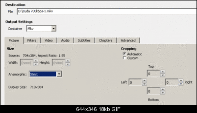

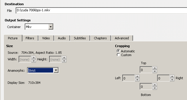

  9. Well I tried deadrats, but you're obviously determined to ignore anything you don't want to believe. It's pretty much impossible to take anything you say seriously now. The output file was not 704x384 with square pixels. I've tried to explain that to you numerous times. I posted a screenshot which shows MPC-HC says the aspect ratio has changed, a screenshot which shows MeGUI agrees, yet you're still playing pretends. I suppose now you'll imagine the Handbrake authors are trying to mess with my head, rather than spend any time in reality yourself?
    Note the Display Size Handbrake shows.
    Handbrake after opening the original AVI.

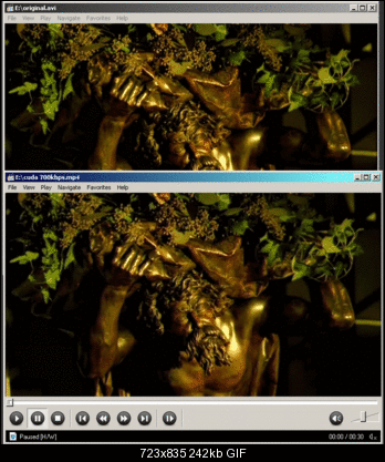

    MPC-HC displaying the original AVI vs MPC-HC displaying the MediaCoder encode. You'll probably find a way to pretend it's not true, but the display widths are different. FFS, that's how I noticed they weren't the same in the first place. I just used my eyes. When I realised they were different, I checked the aspect ratios.
Name:	display widths.gif

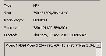

  10. I originally thought deadrats was right. But ffprobe shows that both of hello_hello's cuda encoded files have the SAR flagged as 111:110.
    Thank you!!
    Maybe it's just some odd bug which is only occurring when using MediaCoder on XP, or even just using this particular PC, but I've re-encoded the same AVI several times using the same aspect ratio settings as my screenshot in post #34 and MediaCoder fudged the aspect ratio every time. Is it doing the same for anyone else?
    I tried the same thing using a couple of different source videos, and resolutions of 960x720 and 1280x720 both resulted in square pixel encodes, but it did seem to fudge the aspect ratio of an anamorphic video I tested a tiny bit (I'd need to re-encode a few again to remember which on it was).
    I just tried another quick test encode of a different video. It went in looking like this:
    And came out looking like this:
    So obviously MediaCoder's "keep aspect ratio" setting has it doing some unnecessary rounding at times. If I manually set the aspect ratio to square pixels, it doesn't fudge, but even the "keep pixel aspect ratio" setting sometimes fudges the aspect ratio, even when the input video has square pixels.

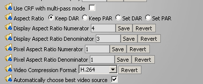

  12. Does MediaCoder save a real log file somewhere? One which shows you the commandlines it's using etc to make second guessing what's it doing a little easier? I can't find one.
    I thought maybe I'd found some "don't mess with the aspect ratio" settings in it's options but changing them didn't make a difference, and I'm not sure i understand what they do anyway.
    [Attachment 24551 - Click to enlarge]
