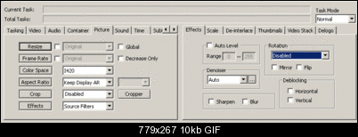

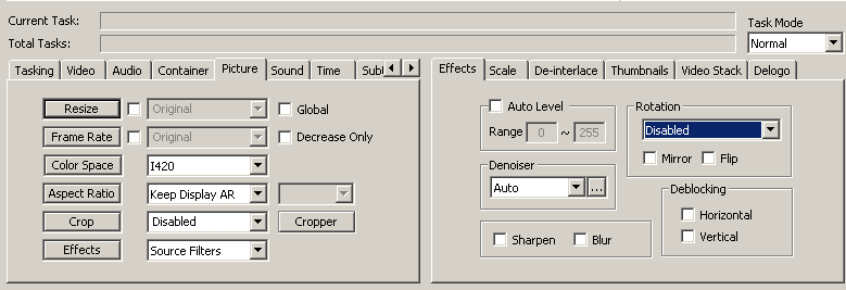

  4. MediaCoder does my head in at times. What is it about these settings:

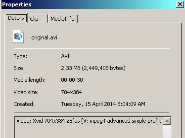

    Which would take a mod16 video with square pixels like this:

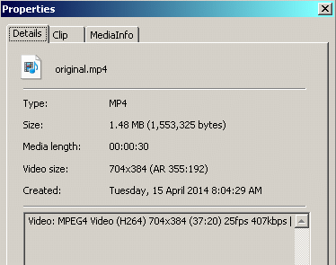

    And give me an encode with an aspect ratio like this?
    The only way I could get "704x384 in" and "704x384 out" was to manually set the PAR to 1:1.
    And that Auto-level option under effects should be hidden away behind a tab nobody will ever look at and where it will never be checked, whether it's deliberately or by accident.

    Seriously?? You're defending a change of aspect ratio when the setting specifically says "keep display aspect ratio"? Because that's what it says. It doesn't say "rounded aspect ratio" or "similar aspect ratio" it says "keep display aspect ratio", and the aspect ratio was 704:384, not some rounded, bad attempt at justifying, non-repeating decimal ratio, it was 1.8333333333333333. The program can output the same resolution and aspect ratio if I specifically tell it I want square pixels, but if I don't crop and resize it can't keep the original aspect ratio according to it's "keep display aspect ratio" setting?? Give me a break......
    All MediaCoder had to do was set the SAR to 1:1. Obviously it didn't. Even the "keep PAR" setting fudged the aspect ratio. Got some irrelevant math which explains why a PAR of 1:1 is changed when the "keep PAR" setting is selected?
    Originally Posted by deadrats View Post
    media coder didn't do anything to your aspect ratio, you chose that aspect ratio when you decided to butcher your source file by cropping away the black borders, the only difference between what it was and what it is in terms of aspect ratio is that media coder, or more accurately the h264 encoder wrote that information into the header and no windows reads that info and displays it, nothing has changed, you're just being slapped in the face with the choices you made whereas before you were in blissful ignorance.
    i hope the above doesn't come off overly harsh but it drives me up the wall the things that some people do to their encodes.
    What a load of twaddle. Of course something changed when the video was encoded. The source had a 704x384 resolution with an identical aspect ratio. The encoded version didn't. MediaCoder did that. How and why that 704x384 AVI came into existence is irrelevant. That's what it was, yet the output wasn't.
    The only choice I'm being slapped in the face with was the one which resulted in me installing MediaCoder again. I could open the same AVI for encoding in any other GUI and without any resizing and cropping I could expect the output video to be 704x384 with exactly the same aspect ratio as the source and my expectation would be met each and every time.
    I hope this doesn't come off overly harsh, but show me one other encoder GUI that changes the aspect ratio as MediaCoder does, because until then I'll be assuming you're a nutter trying to defend the indefensible.
    Edit: For the record, I encoded a 4:3 video as a test (960x720) and correct me if I'm wrong, but there's lots of recurring there too. 1.333333333. For some reason though, MediaCoder decided that was an aspect ratio worth keeping when "keep display aspect ratio" was selected, and didn't feel obliged to round it to something else. Is there a list somewhere which specifies which aspect ratios the "keep aspect ratio" setting errrrr.... keeps?

  16. Originally Posted by deadrats View Post
    you're own screenshots show that the input file was 704x384 with square pixels for an aspect ratio of 1.8333... and the output was likewise 704x384 with square pixels for an aspect ratio of 1.8333...
    So all your silly aspect ratio rounding due to recurring decimals nonsense just went out the window by your own admission?? Pity you're wrong though....
    My two screenshots show the original video has a resolution of 704x384 with no additional aspect ratio information. The encode (second screeshot) has a resolution/aspect ratio of 704x384 (AR 355:192). It's right there in the picture, FFS. Next to where it says "Video size". Can you see it yet?
    First you defend the change of aspect ratio with some mathematical nonsense trying to prove it's expected behaviour, and now you claim there isn't any change. I'd at least have hoped you'd refrain from the smoking crack accusations given you can't make up your mind.
    in fact, i checked all the samples you provided with media info and they all show the exact same resolution and aspect ratio.
    MediaInfo does a whole lot of rounding with aspect ratios in it's GUI. I hope you're not checking that way as it'll be reporting 1.85 yet you've already claimed the aspect ratio remained unchanged at 1.83333. How are you checking the aspect ratios exactly?
    I don't know what basis you have for saying I'm getting the aspect ratio from Windows. I'm getting it from MPC-HC's File/Properties menu. I've never known it not to be accurate. FFS, if I open one of the encodes in one instance of MPC-HC and the original AVI in another, I can see their display widths are different. That's what got me checking the aspect ratios in the first place. I even double checked by opening both the original AVI and the encoded version with MeGUI to see what it displayed as the aspect ratio for each and it confirmed they're different.
