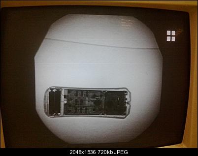

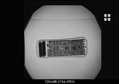

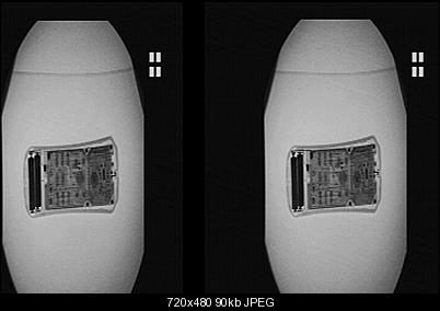

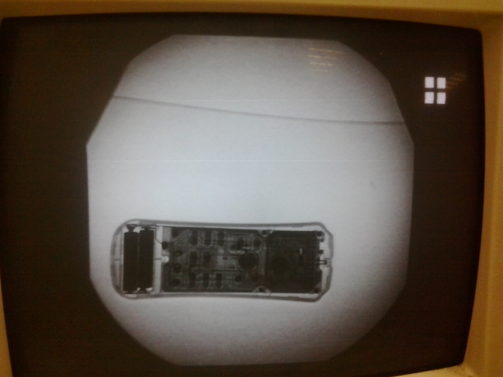

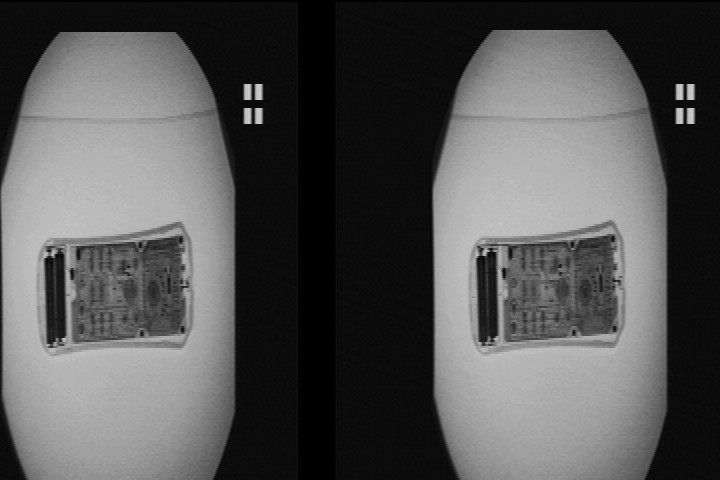

    i try to capture the video from old medical device has a bnc out put
    i used a bnc male to male coaxial cable, lifeview lr138 tv tuner in my pc and adaptor bnc female to rca male attached to rca in the lifeview tv card but the result is not the same as the monitor
ID:	24443Click image for larger version
Name:	2014-04-09 18.26.08.jpg
    the second image is from monitor
    the first is the captured with my lifeview tv card
    n.b that the original image is 1024 spatical resolution
    what is wrong ??? sorry for my bad english

    I bet it's a monochrome 1024x768p60 (approximately) PC/VGA-like output but with composite syncs. It's amazing that a normal SD video capture card is getting anything at all, but many SD (interlaced) video devices will give you double images like that with progressive sources.
    I'm sure there are devices that let you capture PC outputs properly, but I don't know the name of any. It may still be a challenge, as this isn't a standard modern PC output either.
    It is possible to process what you have, but you'll only get about 1/3rd of the original resolution.

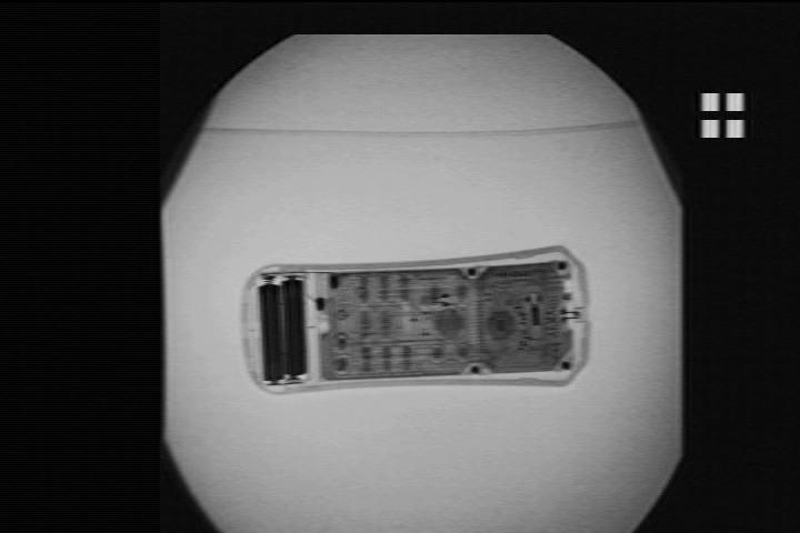

  8. The medical device is probably 640x480p60. That's why there are two image side by side -- twice the scan rate of NTSC 30i so there are two scan lines of the source on each scan line of the cap.
    ImageSource("attachment.jpg")
    PointResize(width,height/2)
    left=Crop(0,0,360,-0).Crop(0,0,-72,0).AddBorders(72,0,0,0)
    right=Crop(360,0,-0,-0)
    Interleave(left,right)
    Sharpen(0.5, 0.0)
    AssumeFieldBased()
    AssumeTFF()
    Weave()
    BicubicResize(width*2,height)
