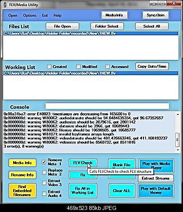

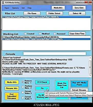

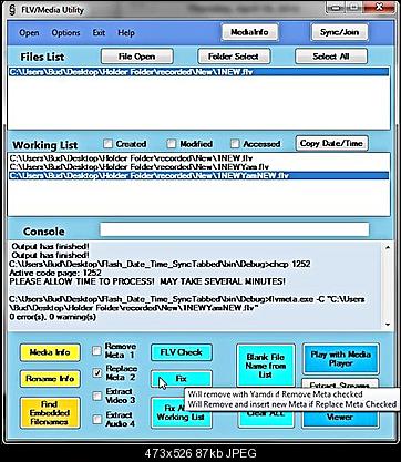

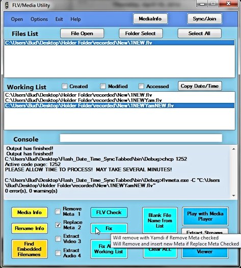

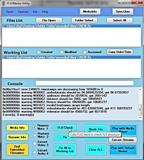

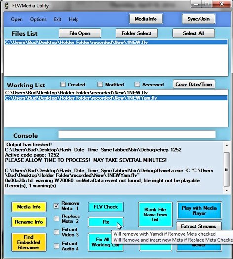

  2. Member Budman1's Avatar
    Jul 2012
    NORTHWEST ILLINOIS, USA
    Many (most?) times FLV can be corrected for the problems of playing wrong, not starting, stopping, unable to seek, etc. simply by removing Meta data and timings and then replacing with Yambdi and FLVMeta.
    To Replace Meta Data
    FLVMeta -t -f "input Video.flv" "Outputvideo.flv"
    To Remove Meta Data
    yamdi.exe -i "input Video.flv" -o "Outputvideo.flv" -M
    I have download tons of FLV and this fixes 99% of them and you do not have to re-encode. It works so well I wrote a kind of composite program to fix them an, unless it is a really messed up FLV it will correct it. Then I use a hex editor!

    Oct 2008
    Russian Federation
    2 Budman1
    All links of FLV/Media Utility had been lost (from google). going to death resources.
    flvmeta, and yamdi can't repair files. about 5 frames of ~40 MB only.
  4. Member Budman1's Avatar
    Jul 2012
    veranyon, Not sure what you mean about 5 frames ~40MB. You have only 5 frames corrupted? Also did you remove first and then replace or just try to replace.
    Best to Remove first. I'm working on a more elaborate version of FLV media Utility that I hope to post on my web site Budmansite.com soon with a help file that explains the many new features for additional media types.
    Let me know the exact problem and result.
