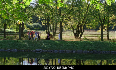

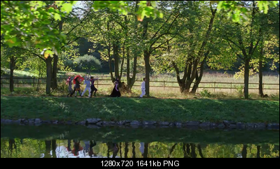

  1. Some people might be thinking - well the shadow detail loss isn't that bad...Maybe only pixel peepers will notice...
    But considering x264 looks like the source at about 65-75% the size of MC without those problems
    Yes, I'm sure you consider those outputs are fine for most people. But there is undeniable texture loss, even at 100%. It's the achilles heel of MC
    And when you actually have high content complexity, lots of motion - the problems and encoder deficiencies are revealed. Surely you can see the difference here ?
    x264 10Mb/s

    VRD 10Mb/s
Name:	vrd 10Mbps.png
