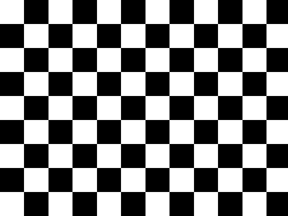

    sam1776 here and jagabo is correct the original size is 576x432 4:3 and im using this (nnedi3_rpow2(rfactor=2, cshift="Spline36Resize", fwidth=720, fheight=480) and the 720x480 is not 16:9 but 3:2 but i want 16:9 widescreen and im doing a old music video from the 80's not a full movie then i can apply this filter to all the videos because they all have the same 576x432 ratio ill try the links from jagabo im making a dvd and i thought that upscaling to 720x480 with nnedi would look better than lanczos 16:9 in convertxtodvd5 thanks for all the help friends

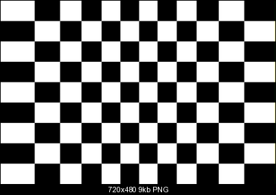

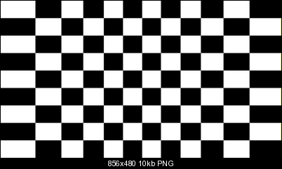

  7. If you want a non-linear stretch you can use something like:
    WarpedResize(856, 480, 0.75, 1.00) # ~16:9
    BilinearResize(720,480) # for DVD, encode 16:9 DAR
    WarpedResize comes with the SimpleResize package. You can modify the third argument to get different degrees of stretch at the edges. 1.0 gives the same stretch across the entire frame (same as normal resize filters like BicubicResize), smaller values keep the middle closer to the source DAR but stretch the edges more.
    That will change this 576x432 frame:
    to this DVD compatible 720x480 frame:

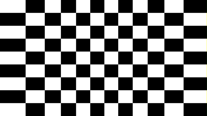

    after encoding to DVD with 16:9 DAR it will display on your TV like this:
    As you can see the center of the picture has retained the square blocks but the edges of the frame are very stretched. This works well for talking head shots where what you focus on is in the middle of the frame. But it looks very bad in panning shots where objects are very wide as they enter the frame from the side, get skinny in the middle, then get wide again at the other edge.
