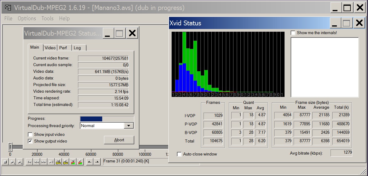

  22. @manono
    Thanks to your help, I am able to run script in VirtualDub.

    Import("C:\Hybrid\avisynthPlugins\QTGMC-3.33.avsi")
    MPEG2Source("E:\Movie\VIDEO_TS\VTS_01_1-Main.d2v")
    QTGMC()
    #yadifmod(mode=1, order=1, edeint=nnedi3(field=-2))
    SRestore()
    VirtualDub is running but is taking ages. Also audio is not being processed.
    Something is wrong here!
    Can you spot what wrong I am doing?
Name:	VDub Progress.jpg
  23. You're doing nothing wrong. QTGMC is slow although you can use faster settings for it. The default behavior for it is the 'slower' preset. You can try the YadifMod I showed as it's faster. Yadif is faster yet. You can trade quality for speed. Or just let it encode two nights and a day (and hope the power doesn't go out).
    As for the audio, MPEG2Source doesn't include the audio. You can add audio in the Audio section of VDub if you like.
    Congratulations! You're encoding now, frameserving with AviSynth. And you didn't think it would ever happen, did you? So you can teach an old dog new tricks.
    You can speed it up by doing a single pass using Quant 3, if you're running 2 passes. That will cut the time almost in half. And you can buy a faster computer. Nothing stresses a computer quite like complex AviSynth filters. You have a computer that was obsolete ten years ago, if your profile is accurate.
  24. Originally Posted by manono View Post
    Indeed, thanks to your help and initiation and for that reason I declare you my guru in AviSynth.
    I really was too intimidated by code/script.
    Two more points in view of
    Edit later: Or were you expecting to play the M2V and hear audio? If so, that's a video-only file. The audio should have been demuxed separately. You can add the audio to the AviSynth script you create but there's no need to. I always add the audio back at the very end, during muxing.
    and
    By the way, that one I kept at 25fps. For my own projects I slow both the video and audio back to film speed . That way the songs are back in tune and the movement is more natural. I can't believe that for films in which the songs are so important, the Indian media companies make all the songs out of tune - a semi-tone too high. If you know any musicians or any people with perfect pitch, ask them about it.
    Can you give the script for above if it is not much trouble?
    Because it will help me back up my DVDs I paid for and got rotten video and eardrum jarring audio.
    Please do as you deem fit.
    Tahnks.
  25. I don't know what you're asking. To slow the video? Add an AssumeFPS(23.976) to the end of the script. That will slow it to film speed. To slow the audio to match I use BeSweet which has a 25->23.976fps preset. But I always work with WAV audio. eac3to can slow AC3 audio from 25 to 23.976 also.
  26. Thanks for the clarification.
    Two more questions
    How do I add audio track to the current video?
    Will switching processor to i3 will make my system fast?
    (2½ days for one movie is too slow)
  27. In i3 will be much faster than a Pentium D. You can also try using a faster preset in QTGMC. Try changing QTGMC() to QTGMC(preset="fast"). Quality will be a little worse but it will be much faster.
  28. @jagabo
    Thanks.
  29. Originally Posted by ConverterCrazy View Post
    Open the XviD AVI in VDub and set Video for 'Direct Stream Copy'. Add the audio in the Audio tab and then File->Save as AVI.
  30. Thanks. @manono
