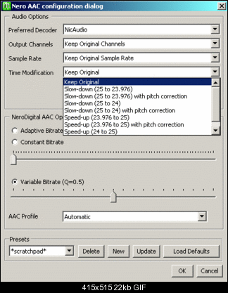

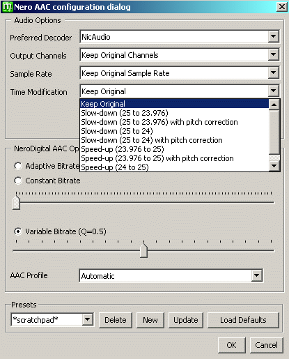

  5. MeGUI has options for speeding up and slowing down the audio in it's audio encoder configuration. In older versions (and maybe the current stable version) it's under the section for changing the sample rate. Newer versions of MeGUI have a drop down box labelled "Time Modification" in the audio encoder configuration. If you switch to the development update server in MeGUI's options, updating should get you the latest version of MeGUI (and possibly the latest bugs).

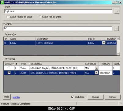

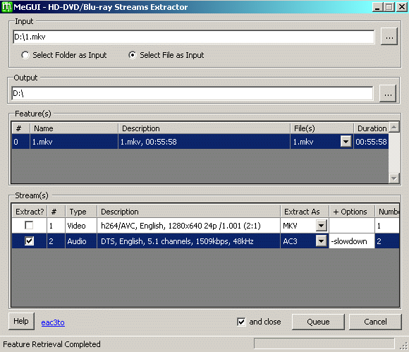

    HD Streams Extractor/eac3to (under the Tools menu)
    http://en.wikibooks.org/wiki/Eac3to/How_to_Use#Command_Line_Syntax

  7. MeGUI's audio encoder uses the same method as BeHappy and BeSweet for the resampling/slowdown/speedup stuff without pitch correction, as far as I know. They use SSRC.
    MeGUI uses an Avisynth plugin (TimeStretch.dll) for slowdown/speedup with pitch correction (Avisynth+). I think BeHappy does the same. The function is built-into the official versions of Avisynth. I'm not sure if BeSweet does pitch correction. manono would know.
    A warning entry in MeGUI's log file was recently added when the time modification with pitch correction options are used:
    [Warning] When TimeStretch() is used with more than 2 channels, each channel is processed individually in 1 channel mode. This will destroy the phase relationship between the channels.
    Whether that's as bad as it sounds, I don't know. Maybe the same applies no matter how pitch correction is done. I've no idea.
    The HD Streams Extractor and EAC3to Conversion Utility both use eac3to for resampling/re-encoding, and it has a reputation for quality. It doesn't pitch correct.... at least as far as I know.
    That's about the extent of my knowledge. Time stretching is something I rarely do, but if I do, it'd mostly be to go from PAL to NTSC or PAL to film and I probably wouldn't pitch correct it as usually there's no way to know if the PAL version was pitch corrected originally.
