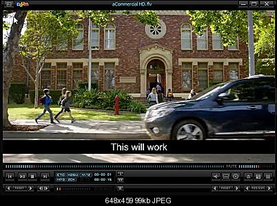

  2. Your best bet is to render your video with a black bar at the bottom -- so the subs will be rendered in the black bar.
  3. Member Budman1's Avatar
    Jul 2012
    NORTHWEST ILLINOIS, USA

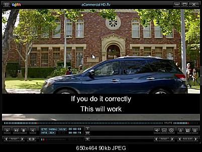

    If you wish to have it EXACTLY like the above example , you can do it with AviSynth.
    1. Create a black? band the width of your video. In my case it was 640 and I made it 640x50 for 2 lines height. I saved it as image1.jpg
    2. Create the aviSynth script:
    LoadPlugin("C:\Program Files (x86)\AviSynth 2.5\plugins\ffms2.dll")
    v = FFVideoSource("C:\Users\Bud\Desktop\aCommercial HD.flv")
    A = FFAudioSource("C:\Users\Bud\Desktop\aCommercial HD.flv")
    ab = AudioDub(V, A)
    ac=ImageSource("C:\Users\Bud\Desktop\Image1.jpg",p ixel_type="RGB32")
    ad=Overlay(ab,ac,x=0, y=290,opacity = 1.0,mask=ac.ShowAlpha())
    #Opacity runs from 0.0(transparent ) to 1.0 (fully opaque)
    Return ad
    3. Load the script into Virtualdub or whatever you are going to use for subtitle addition.
    I used ffms2 because I've had some problems with Directshowsource and avisource but they may work for you as well. in which case use:
    ab=directshowsource("C:\Users\Bud\Desktop\aCommerc ial HD.flv")
    Return ad
    You should receive
Name:	ScreenHunter_59 Apr. 06 10.19.jpg

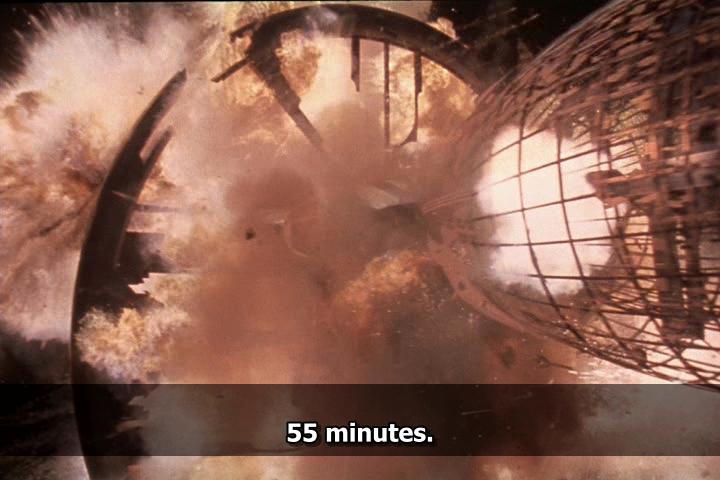

  5. You can also do something like this:
    YPOS=384
    HEIGHT=72
    ffVideoSource("vid.mpg")
    darkbar=last.Crop(0,YPOS,-0,HEIGHT).ColorYUV(gain_y=-128, cont_u=-128, cont_v=-129, opt="coring")
    Overlay(last,darkbar,0,YPOS)
    TextSub("vid.ass")
  6. @Jagabo.
    Do i supposed to run all this in avisynth? If yes, then please go step by step, as i am totally new to this. Please explain, it would be of great help.
    Or you can give me the reference where i can learn, avisynth.
  7. You don't need to use AviSynth for this. You could use any NLE to add a dark bar then render subs on top of it.
    But if you want to learn AviSynth: http://avisynth.nl/index.php/Main_Page#New_to_AviSynth_-_start_here
    In my script YPOS is the vertical position of the top of the dark bar. HEIGHT is the height of the bar. You can control the brightness of the bar within the ColorYUV() filter. I set the brightness (gain) to -128 which represents a 50 percent reduction of brightness. You could set it to -256 for a totally black bar.

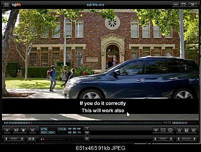

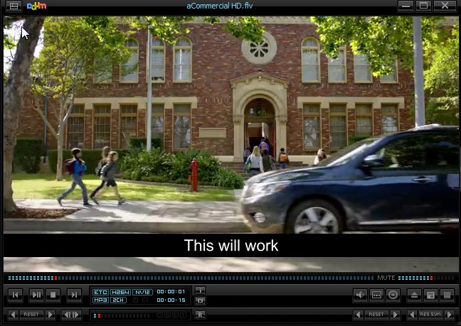

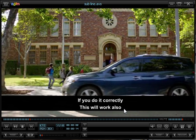

    Using Aegisub for creating your subtitles is fine but this process will be used in the one where you create the video with the black band ready for the display of the subtitles. Also, you must have AVISynth installed to use this method.
    1. First you must create a small image that is just the black band that you will overlay on top of your video at the point you wish. Since my video was 640x360, I used a graphics editor (paint shop Pro)to create an image 360x50 and filled it with the color black.
    2. Now that you have your overlay image, you create the AVISynth script you will use in place of the actual video. Use a text editor and create the lines of the script as mentioned above and save with the extension AVS. Example: "video Name.avs"
    3. In my case I played the AVS file with Potplayer and selected the subtitle file I wanted it to use. The avs file did as the script tells it to. Display the video, overlay the black image1.jpg, 290 pixels down the screen (290 + 50 in height = 340, leaving 20 pixels of video at the bottom of my 360 high video). This is only to PLAY the video with the subtitle band displayed.
    4. If you wish to make a permanent video with the band PERMANENTLY embedded over your video, you will need some kind of video editor that accepts AVISynth files such as VirtualDub, FFmpeg, and many others. When you finish you will have a video with a black band across it. If you play it and select your subtitles, they should show up in the band. You may have to adjust location if your subs are ASS or SSA. I used SRT as default location. I used FFMpeg as command line with the line:
    ffmpeg -i "C:\Users\Bud\Desktop\sub line2.avs" -acodec copy -crf 20 -vcodec libx264 "C:\Users\Bud\Desktop\Commercial.flv"
    5. Optional : If you are going to embed your subtitles as well, then use a program such as VirtualDub, load the AVS file into it and add your subtitle filter and create the finished video in one process.
    You can PM me if you have more questions on THIS procedure.

    According to the SSA/ASS specifications, "BorderStyle=3" gives you an opaque box around each subtitle entry.
    IMNSHO, this would be much better than a dark bar screwing the picture during the entire playback time...
