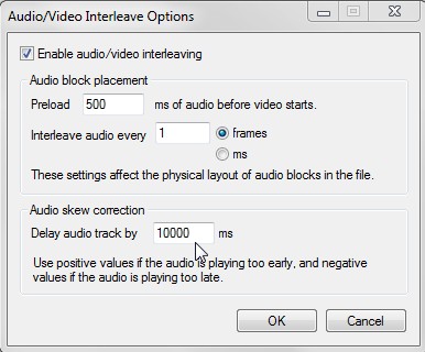

    If you just want to delay the audio with VirtualDub, select Audio -> Interleaving and set the delay in Milliseconds (10000 for 10 seconds).
    Otherwise FFmpeg will do a quick job of it with:
    FFMpeg -i video.avi -itsoffset 10 -i audio.xxx -map 0:0 -map 1:0 -vcodec copy -acodec copy output.avi
    Name:  ScreenHunter_59 Apr. 06 09.32.jpg
