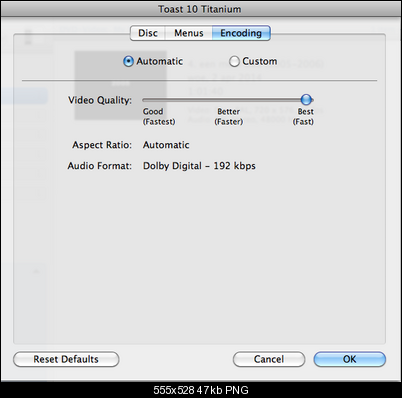

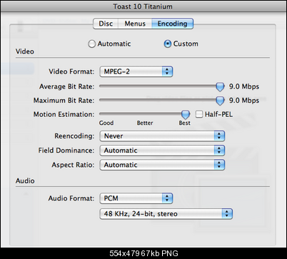

    I burnt old iMovie HD projets to DV (full quality) for archival purposes.
    Later I created Disc Images from the DV's, using these settings in Toast 10:
Name:	Screen shot 2014-04-06 at 12.15.41.png
    When played on my iMac the SD video's from the disc images look like they should:
    http://files.videohelp.com/u/203833/2.%20first%20steps%20(2003-2004).dv
    But, when burnt to DVD (again by using Toast), they look bad on my standalone DVD-players. There's some flickering, a stroboscopic effect:
    http://files.videohelp.com/u/203833/VTS_01_1.vob
    Any idea what's wrong?

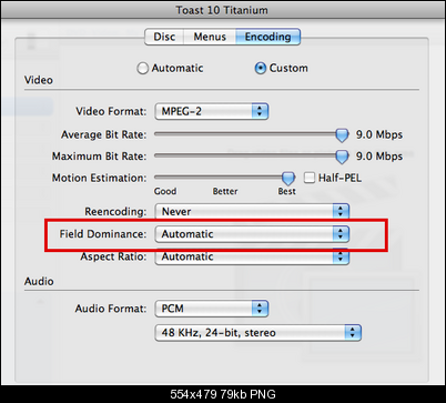

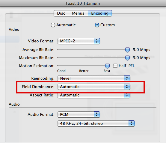

  4. Your field dominance is wrong. Don't set it to automatic.
    Edit: just double checked your clips with Mediainfo. The bad clip is top field first, set your encoder to to lower or bottom field first.

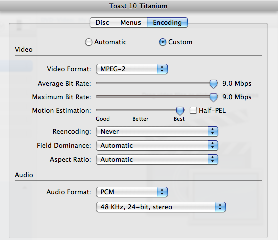

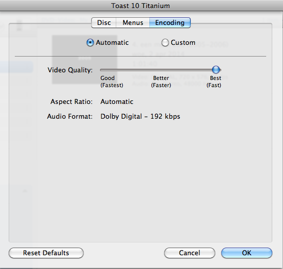

    smrpix, Thank you for your help.
    In the meantime I solved the problem by readjusting the settings in Toast.
Name:	Screen shot 2014-04-06 at 19.16.41.png
    The video now looks great on DVD.
