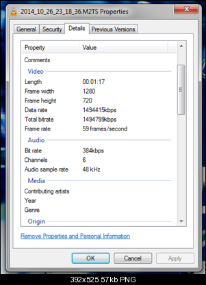

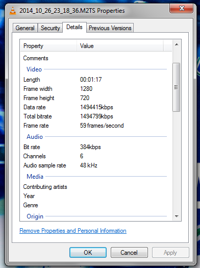

  15. I capture my videos at about 7.7MB/sec (variable). The file that I have here is showing as
Name:	2014-10-27 10_36_36-Greenshot.png

    The strange datarate (in the screenshot above) seems super weird. That's far higher than the Hauppauge capture device can even run at I believe (by my math, that's 1494 M/sec?)
