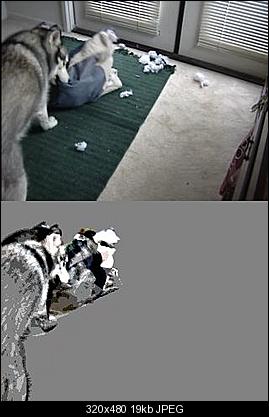

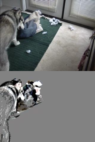

You want this to have a quick way of locating the motion sequences? In AviSynth you could subtract the frame from the previous frame leaving a frame that shows only the differences.
That would give you a video that's flat grey when there is no motion, and obvious detail when there is motion:Code:vid = WhateverSource() prev = Trim(vid, 1, 0) # remove first frame sub = Subtract(vid, prev).ColorYUV(cont_y=-244).ColorYUV(cont_y=10000) return(sub)
On the top is the original image, On the bottom is the "motion" image. The first ColorYUV() reduces the contrast to eliminate low level noise (fine tune this for your particular video). The second one increases the contrast greatly to make the result very obvious. -
