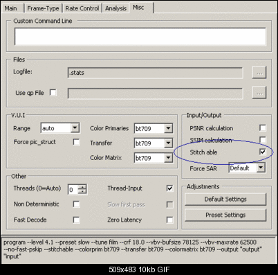

  9. x264 has a fairly recently added option called "stitchable". Whether the version of x264 Handbrake uses requires it I'm not sure, but I'm pretty sure you can't add it to the Handbrake commandline. It may be why you're having trouble appending the encoded files. I assume MKVmergeGUI offered some sort of warning at the time?
    https://mailman.videolan.org/pipermail/x264-devel/2013-July/010167.html
    MeGUI added the option to it's x264 encoder configuration a fair while ago.

    Originally Posted by MarylinC View Post
    My question is am I making an error choosing a frame width above the 720 the DVD says it is or is it OK to go up to 1024 wide without simply blowing up the pixels?
    I didn't think Handbrake would let you resize DVDs to width greater than 720? Maybe you're using a newer version which does?
    If you use Vidcoder and encode using "anamorphic none" it defaults to 1024x576 or 854x480 etc, so there's nothing wrong with it. I don't use anamorphic encoding myself as a couple of the media players in this house don't display it correctly (they assume all MKV/MP4 files have square pixels) so I always "resize up". There's no rules though. I've found for PAL I can usually resize to 960x540 without any loss of detail compared to 1024x576 and it helps reduce the file size a tad. It might depend on the sharpness of the resizer a little (I don't use Handbrake myself). If the video is interlaced, after de-interlacing you can often get away with a slightly lower resolution. It's personal preference. Is the video interlaced? De-interlacing can cause a reduction in quality which wouldn't be the encoder's fault.
    If you encoded using a quality (CRF) value, then took the resulting bitrate and used it for a 2 pass encode, the 2 pass encode would be encoded in the same way. Unless you need a particular file size, I'd use CRF encoding instead.
    CRF18 is roughly where the x264 encoder is considered to be transparent. Higher CRF values = lower quality. I use CRF18 and Tune Film for pretty much everything up to 720p. For 1080p I tend to use CRF20 to help keep the file sizes down. Even for DVDs though, CRF20 should still look pretty good.
    If you re-encode the MKV you created after using MakeMKV and then appending the two with MKVMergeGUI you might end up with slightly out of sync audio after the middle point. You may, you may not. I'm not sure how good Handbrake/Vidcoder are at keeping audio sync if there's gaps in the audio stream, but if you do, there's ways to fix it.....
