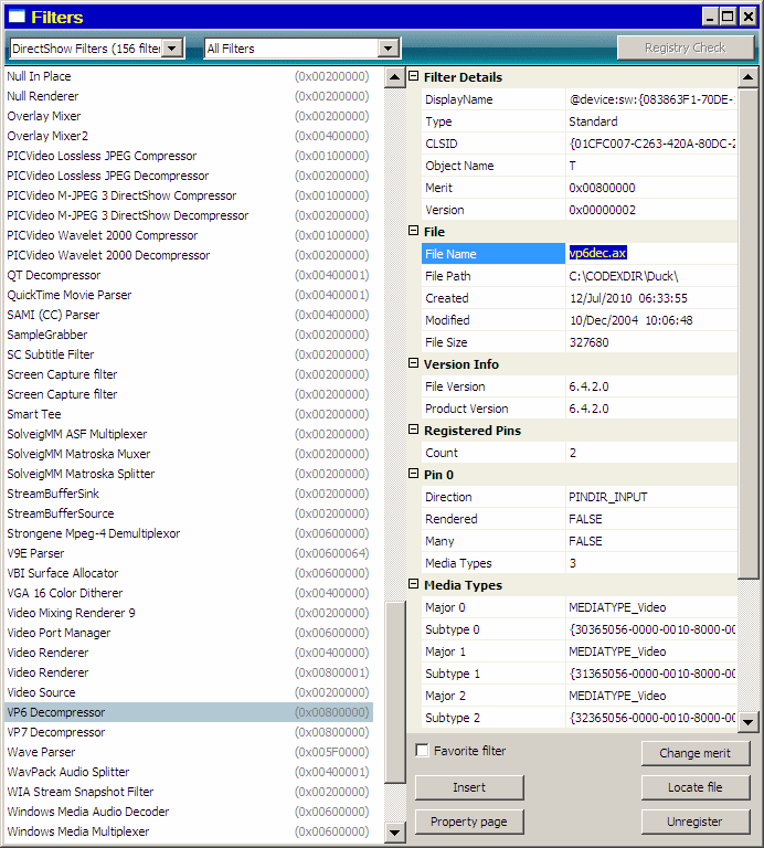

    Just complementing what jagabo said:
    first, make sure you have downloaded and installed on2_vp6_decoder.exe ,
    secondly, MPlayer surely can use the VfW version of the official VP62 decoder, and probably
    may be configured for using the DirectShow filter as well.
