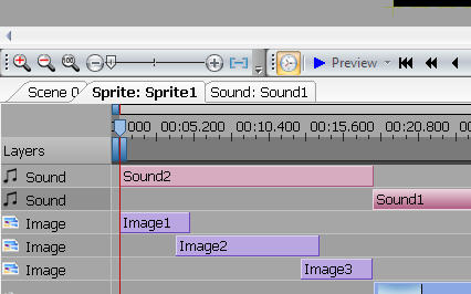

    I have learned how to use the Properties window to adjust the audio volume of an entire video or sound (audio) clip. But I have not figured out how to adjust a sound clip to have it fade in and/or out after the clip has been placed on a project's timeline.
    Below is a screen grab of the timeline in question. The Sound2 clip is background music to run while the three images below it cause the title to fade in and out. I would like to have the music fade out at the end of its run. Worst case, I can do that editing in my audio-editing program and then place the edited file on the timeline, but I'd rather do it in the VSDC program itself.

    Got your email message regarding my YouTube tutorial. The latest version of VSDC includes quite a few audio editing updates. It's easy to do what you're requesting directly from the program.
    1. First click on the Sound2 bar in the timeline to select it,
    2. then click on its tab located directly above the timeline to open it.
    3. In the main Editor menu, click on Audio Effects / Amplitude / Fade out
    4. Verify "To Scene End" is selected, then click OK.
    You can fine adjust this fade out from its properties window on the right, mainly adjusting its duration (length of the fadeout), and ending volume.
    And as mentioned, there are a lot of other audio editing filters with the latest version of VSDC. Make sure to try them out. You apply them the same way as for the fade out.
    Good luck!

    t00nz843z,
    Thanks a lot. Your instructions were very clear, and the process worked perfectly.
