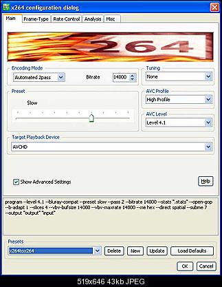

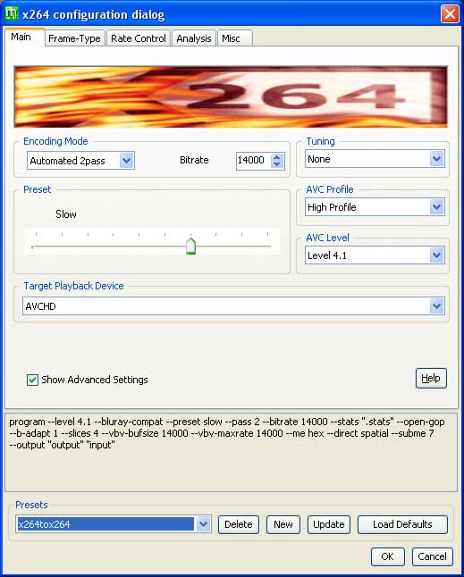

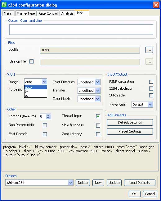

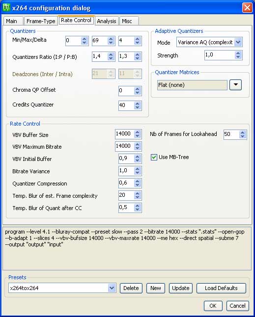

    Hi everybody. I'm trying to go from x264 to x264 (for cropping purposes) using MEGUI, an AviSynth script and x264. The master file plays ok using Media Player Classic HC. That means you can point the cursor on the timeline wherever you want and you can see the result immediately. Same thing is not happening with the newly encoded file. It is perfect as the master file (crystal clear) and plays great on my Samsung HDTV, but using Media Player Classic HC, as you move the cursor, it does take a bit of time (some seconds) to respond. My question is: what am I doing wrong? Here are some screenshots. Maybe there's something wrong with the Misc Guide: V.U.I.>Range>auto/tv or pc... Help will be greatly appreciated. Thanks in advance.

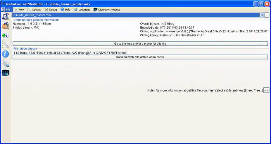

    -That's a very interesting question. The file is also x264 (AVC); here's what MediaInfo shows:

  4. When you encode, are you outputting directly to MKV, and are you trying to play the re-encoded version without remuxing it? If you open the re-encoded version with MKVMergeGUI, or with MeGUI's MKV/MP4 muxer and resave it, does the saved version play better using MPC-HC?
    If you output directly to MKV, the resulting MKV isn't indexed, so MPC-HC indexes it when you try to play it which can make opening/seeking really slow (something like that). If the output is MKV and I'm correct, remuxing the output MKV should fix it. Normally you'd remux it to add additional streams such as audio and subtitles etc anyway.
    I doubt the settings you're using are the problem, but are you using AVCHD as the target playback device for a particular reason? If you're not creating AVCHD complaint video and just converting to MKV or MP4 etc to play the encodes via USB, none of that Bluray compatibility stuff is necessary. Even if you're using a Bluray player. Via USB, support for High Profile, Level 4.1 is pretty standard. Selecting DXVA as the target playback device should do.
  5. PS. When you use the bluray compatibility option, the keyint settings (GOP size) are automatically set to 24 and 1, or 25 and 1 etc, depending on the frame rate (Edit: I got that a little wrong. See post #9). That means the maximum GOP size is one second. The defaults are 250 and 24 (or something similar, depending on the frame rate) when means the maximum GOP size is 10 seconds and 1 second is the minimum. The defaults will probably increase the quality a bit for a given bitrate.

    PPS. For MediaInfo, try selecting View/HTML or View/Text. You're only seeing the bare minimum of info with the default view.

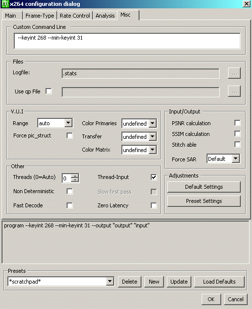

    PPPS. The stuff under V.U.I in the x264 encoder configuration doesn't change the way the video is encoded, it just causes x264 to write info to the video stream. Unless you understand it, it's probably best just to leave it all at the default settings.
    http://mewiki.project357.com/wiki/X264_Settings#Video_Usability_Info

    Thanks for taking time to respond, hello_hello!
    - Yes, I am outputting it directly to MKV and again, yes, I'm trying to play it without remuxing it. But even after remuxing the whole thing using MKVMergueGUI, as you move the cursor using MPC-HC, there's still a delay (BUT not as long as before) when playing the desired position.
    - Since the "master file" was encoded this way @High Profile, Level 4.1 ACVHD, Bitrate 14,000) I was just trying to keep the same settings and quality.
    -That's my case (play the encoded version via USB). Thanks for suggesting DXVA as the target playback. Will it work great? I had chosen before PS3 and Xbox360 and got a file full of blocks. That's why I've chosen AVCHD (also to keep the same original file config).

  8. Originally Posted by Cunhambebe View Post
    How much of a delay are we talking about? For me, once the MKV has been remuxed, even with "fast seek" disabled, it's usually very small. Under 1 second. A little longer does happen at times, but probably not by much.
    Edit: I just happened to be watching a 1080p video so I tested it, and at that resolution, the delay in seeking probably averaged somewhere between almost none and two seconds using MPC-HC, with "fast seek" disabled. That wasn't a particularly high bitrate video. I guess I'm just used to the slight delay and don't think about it.
    There's no need to do that as such. The encoder just sees uncompressed video which it re-compresses. There's no point duplicating the settings used when encoding the original file unless they're the settings you want to use.
    The "master" wasn't encoded using any type of ACVHD setting. You might be confusing the average bitrate and VBV settings. The bitrate you specify is just an average bitrate, which varies considerably. The VBV settings limit it (they actually apply limits to the decoding buffer).
    http://mewiki.project357.com/wiki/X264_Settings#vbv-maxrate
    I've not met a TV with a built-in media player or a Bluray player which won't play High Profile, Level 4.1 using the default settings (in MP4 or MKV). No Bluray compatibility required. My other half has an old Sony S360 (I think) Bluray player. It doesn't even have a USB input, but it'll play my encoded MKV/MP4 files if I burn them to disc. I pretty much always use CRF (quality) based encoding myself. Unless you need a particular file size for some reason, it's probably the better way to do it. That way, quality relative to the original should be the same each time (for a given CRF value). File sizes will vary quite a bit. I just select a CRF value, an appropriate tuning and the slowest speed preset I can stand (usually just Medium or Slow in my case) and encode that way. My MeGUI command line (in the x264 encoder configuration) would generally just look like this:
    program --level 4.1 --preset slow --tune film --crf 18.0 --vbv-bufsize 78125 --vbv-maxrate 62500 --output "output" "input"
    If you wanted to be paranoid about something, you could probably pick the VBV values. I recently tested my Samsung TV's media player and my Sony Bluray player while re-encoding a video with an unusually high bitrate (it had sections at 100,000kbps). I re-encoded it using a low CRF value to increase the average bitrate a bit ,while applying various VBV settings. The Sony Bluray player didn't seem to care and happily played the original file. The Samsung TV stuttered until I re-encoded it using --vbv-bufsize 58000 --vbv-maxrate 58000. Normally bitrates wouldn't get that high anyway, but the "worst case scenario" might be to use the "DivX HD" target playback device settings:
    --level 4.0 --vbv-bufsize 25000 --vbv-maxrate 20000
    I don't bother myself, but I know some people use lower VBV settings to make sure the bitrates don't get too high for some devices. Something like this (they're the VBV values displayed by MediaInfo for your "original" video):
    --level 4.1 --vbv-bufsize 30000 --vbv-maxrate 30000
    For Bluray I think it's officially --vbv-bufsize 30000 and --vbv-maxrate 40000
    Thanks for all the tips. Enabling the MPC-HC option "fast seek" seems to do the trick I'll try to encode the file once again choosing DXVA (it takes a long time to encode it - last time it took 16 hours)
    There's no need to encode the whole thing just to test it. Once you've created a script, open it with the AVS Cutter under the Tools menu. Set your start and end points for encoding (or multiple start and end points if you want to). Save the "cuts" to the script. You can also save a "cuts file" to load into the audio section so it's encoded to match. Or the Audio Cutter under the Tools menu can use the cuts file to split and rejoin the audio without re-encoding it. Anyway.... using the AVS cutter you can encode just a minute or so of the video for playback testing. No need to encode the whole thing each time.
    PS From the MediaInfo stuff you posted your original video has an average bitrate of 14000kbps and a maximum bitrate of 30000kbps. When you re-encoded it, it appears your VBV settings limited the maximum bitrate to around 14000kbps. You also specified 14000kbps as the average bitrate in the x264 encoder configuration. As a result, the VBV settings seem to have caused the final average bitrate to end up at around 13200kbps. Instead of the bitrate being able to vary a fair bit, you've squished it down to something closer to a constant bitrate. The bitrate needs to vary as required for a consistent quality, so use the VBV settings a little less enthusiastically Or don't use AVCHD as the target playback device.

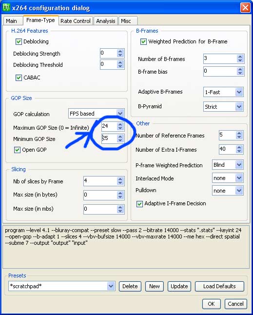

    I thought that was a little odd so I ran a few quick test encodes.
    Turns out --bluray-compat reduces --keyint_min to 1 but doesn't change the --keyint value. I'm not sure why.....

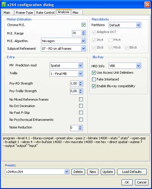

    When you select Bluray as the target playback device, MeGUI adds the following to the commandline.
    Behind the scenes it changes --keyint to 24, 25, or 30 etc, depending on the frame rate.
    --level 4.1 --bluray-compat --open-gop --slices 4 --vbv-bufsize 30000 --vbv-maxrate 40000
    Some of those settings do seem to have an effect on compressibility, especially --keyint. My three little test encodes, CRF18 each time:
    With just --bluray-compat in the commandline: 5.4MB file size.
    With Bluray as the target playback device: 6.8MB file size.
    Default x264 settings: 5.3MB file size.
    It was only standard definition video and the average bitrates were under 1000kbps, so the VBV settings wouldn't have made any difference.

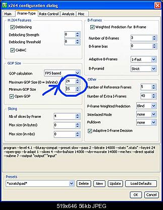

    São Paulo - Brazil
    Thanks again you guys, but really, I guess I have missed something.
    As suspected...
    Original: keyint=24
    Copy: keyint=240
    So what? What can I do to change that value to 24? Is there any way to do that?
    BTW, I have modified the AViSynth script adding Trim(0,8700) so this way render times were reduced for testing purposes. Without modifying anything at all but only targeting AVCHD and DXVA, and lowering the bitrate to 1970, I got files with the same size, excellent quality but same results described in the beginning of this topic (delay to reach parts of the movie when watching with MPC-HC). So where do I wind up with this?
    Thanks in advance.
    Aug 2013
    Central Germany
    @ hello_hello:
    The parameter "--bluray-compat" handles several basic options, but there are also more parameters one has to add to a complete command line to make the result really Blu-ray compatible, like VBV and GOP limits. There are constraints related to the VBV and Profile@Level if a maximum of 1 or 2 seconds per GOP is allowed; x264 is probably unable to consider them in every case, especially if not all parameters required to calculate these constraints are explicitly given.
    @ Cunhambebe:
    MeGUI - x264 configuration dialog, tab "Frame-Type", control group "GOP size"

  12. Originally Posted by Cunhambebe View Post
    As suspected...
    Original: keyint=24
    Copy: keyint=240
    Thanks in advance.
    I wouldn't change the GOP parameters (keyint values). The keyint values are set by the GOP parameters in MeGUI's configuration. You'll see MeGUI adding keyint values to the commandline when you change the GOP settings. You'll probably also need to change the GOP calculation setting to "fixed" if you want to set it yourself.
    The way x264 works by default, it generally puts a keyframe at the beginning of a scene change. The maximum distance to the next keyframe is ten seconds. --keyint 240, or --keyint 250 etc, depending on the frame rate (24 or 25 frames per second etc). The beginning of a scene is a good place to put them. If you force the encoder to use a keyframe every second you'll effect how efficiently it can compress the video. For a given bitrate it'll probably reduce the quality. For a given CRF value it'll increase the file size. Whether it's a quality difference you can see is another story.... it probably depends on the bitrate/quality being used.
    What I wrote in an earlier post was wrong (I've corrected it). --bluray-compat own it's own doesn't reduce the maximum GOP size. Selecting Bluray as the target playback device will cause MeGUI to reduce it according to the bitrate (--keyint 24 or --keyint 25 etc). You won't see it in the commandline in the x264 encoder configuration, but you'll see it when displaying the encoder settings with MediaInfo.
    How long is this seeking delay you're referring to? If it's just a second or two, it's a small price to pay for more efficient compression. If you enable "fast seek" in MPC-HC, then seeking will be virtually instantaneous anyway.
    As I said (added) to my earlier post. I tested a 1080p video and seeking delay seemed to be anywhere between almost nothing and a couple of seconds with fast seek disabled. I'm so used to it I don't even notice.

    I found out this at Wikibooks:
    keyint Integer: 250 (...) Lower settings can reduce the time needed to seek to a certain frame. Recommendation: Default, or 10x whatever your framerate is. On HD encodes which will be CPU challenging you may want to use smaller values (say 2x - 5x fps).
    -Great! I guess 24 would do the trick (since the video is at 23,976) - I'll try the same value here as the one shown for the "master file".
    min-keyint Integer: 25 Sets the minimum length between IDR frames. See keyint for an explanation of IDR frames. Very small IDR ranges can reduce 'incorrect' frame placement (for example, a strobing scene). This option limits the minimum length after each IDR frame before another can be placed. Recommendation: Default, or whatever your framerate is.
    -I have chosen default and encoded again a new test file. The result is great. The problem is gone. Now you can move the cursor and reach the chosen part of the movie with no delay at all.
    Here's the guide:

    Conclusion: maybe MEGUI needs to be fixed because the values seems not to be the same as the chosen ones. Anyway, it works, would only like to know if other x264 GUIs have the same "problem" if it is a real problem.
    Thanks you guys...
    Cheers
    Mark

  14. Originally Posted by Cunhambebe View Post
    The recommended setting is the default of keyint 250 or 10x the frame rate. 24fps x 10 = 240
    Here's the guide:
    [Attachment 24358 - Click to enlarge]
    That's not the default. Not to mention, you've set the minimum GOP size to 25 and the maximum to 24.
    I explained the idea behind having a maximum keyint of 250 in a previous post. The idea of having a minimum of 25 would be to stop x264 from using a lot of keyframes in a very short space of time because it's detecting scene changes (for example, a strobing scene). I think you're misinterpreting the wiki. It says in the part you quoted the recommended keyint_min setting is the same as the frame rate. There's a reason why keyint=240/250 and keyint_min=25/24 are the defaults.
    Now let's see what MediaInfo says:
    keyint=23 / keyint_min=1
    You selected keyint=24 and keyint_min=25 which doesn't really make any sense and you ended up with keyint=23 and keyint_min=1 which is at least logical. It looks like you're still using the AVCHD preset which is why you got the keyframe settings you did.
    x264 seems to automatically set keyint_min=1 when you use --bluray-compat, and you selected --keyint=24 yourself. MeGUI may have changed it to 23 because of the GOP "FPS Based" setting. Hover your mouse over it and read the tooltip.
    -How long? Just a couple of seconds using MPC-HC. Anyway, I guess you're right, since the file plays very well on my Full HD TV, but what would you do? Would you leave it the way it is (keyint 240; keyint min. 1) or change those values? Thanks in advance. Please I would like to know your advice.
    I don't touch the default keyint settings myself. I leave them and the result is keyint=250/240 and keyint_min=25/24 etc, depending on the frame rate (keyint=24 and keyint_min=1 are not the x264 defaults, they're only the defaults for Bluray and AVCHD). With fast seeking disabled in MPC-HC there's a slight seeking delay using keyint=250/240 and keyint_min=25/24. If it bothers you, why not just enable fast seeking?
    Did you read the info in my earlier post regarding the VBV values you're using? I'd get rid of them (I think I edited the post to add it to the end so maybe you missed it.... post #8).
    -No, I didn't because I was typing my response. Thanks for those tips.

  16. Originally Posted by Cunhambebe View Post
    2) DXVA, setting keyint=240 and keint_min=24 (for those 23,976 sources), leaving bluray-compat unchecked and as you have mentioned, getting rid of those VBV values.
    If you leave the GOP settings as the defaults in the MeGUI encoder configuration. Without --bluray-compat, MeGUI will set the GOP parameters according to the frame rate. keyint should always be 10 times the frame rate.
    For high frame rate video (ie 50fps or 60fps) you'll end up with keyint=500 or keyint=600 etc. If that causes seeking to be too slow or gives you problems with a standalone player you might want to limit it to something like 250 yourself. I think you'd need to change the GOP Calculation setting to "Fixed". Either that or leave it on "FPS Based" and set the maximum to 125 and minimum to 12. I think that'll halve the keint setting for a given frame rate, based on the formula MeGUI uses to calculate it.
    If you set max GOP to 125 for 60 fps video, MeGUI should calculate it this way ("FPS Based" GOP calculation enabled):
    125/25 x 60fps = keyint 300.
    If you set min GOP to 12 for 60fps video:
    12/25 x 60fps = keyint_min 28.
    To be honest that's something I'd not thought about myself until now. I just checked a few 50fps encodes and they all used keyint=500 and keyint_min=50. I've had no problem playing them using MPC-HC, which I guess is why I hadn't thought about it before. I'm pretty sure I've used the media player in the TV to play some of them and didn't have a problem. I'll test one shortly just to make sure.
    Thinking about it, that might help explain why when I de-interlace to 50fps the resulting file size for a given CRF value isn't all that much larger then if I de-interlace the same video to 25fps. For the former the max/min GOP sizes are doubled, so even though it has twice as many frames, it'd still have a similar number of keyframes.
    Now you've got me wondering about it I'll have to run a test encode at 50fps while reducing the keyint settings to 250 and 25, just to see how much difference it makes.....

    You see guys.. it is a little tricky. Now I don't know if it's MEGUI or the Codec itself. For instance, back to the AVCHD profile, it doesn't do any good to choose any figure for the bitrate on the Main Guide since on Rate Control Guide, VBV Buffer Size and VBV Maximum bitrate values are always set to 14000. You can never increase them, but you can decrease them. So this might clear to hello_hello his remarks on the values I have chosen for the bitrate (at the end of post #8).
  21. Originally Posted by Cunhambebe View Post
    Not really.
    Normally the bitrate would be variable, the VBV settings are ways of limiting it to stop it getting too high. It's so the video can be decoded without stuttering when using a particular device. You'd set the VBV restrictions according to the device.
    Another example, choosing DXVA, you can set an average bitrate of 14000 and on the Rate Control Guide, set a maximum value of 30,000. That makes sense, but then the CBR and VBR are gone since they are only Blu-Ray. I know it is not that difficult. I'll keep trying it.
    I'm not sure what you mean by "then the CBR and VBR are gone since they are only Blu-Ray".
    If you're referring to the stuff under "Bluray" such as "HRD Info" etc in the encoder configuration, that's nothing to do with the bitrate being variable as such. They're just parameters which need to be set when encoding for Bluray. If you're not trying to make a compliant Bluray video disc, then you don't need to worry about them. If you are, check the Bluray compatibility option or use Bluray as the target playback device.
    If you select AVCHD as the profile, MeGUI automatically sets the VBV restrictions required for AVCHD. It won't let you increase them in the GUI because they're the restrictions required. The same applies to setting other target playback devices. If you need higher VBV restrictions then the AVCHD profile can't be what you want.
    You can over-ride (increase) the VBV restrictions MeGUI automatically uses if you manually choose the AVC profile and level (ie High Profile, Level 3.2 etc) but you can't over-ride them when a target playback device is selected, because it'd defeat the purpose of selecting a target playback device. When a target playback device is selected you can reduce them, but not increase them.
    If you're just encoding to create MKV or MP4 files, choose DXVA as the target playback device, (or select High Profile, Level 4.1 as that's all DXVA does) and pick a tuning, speed preset and bitrate (well choosing a quality would be better, but pick a bitrate instead if you need to). Don't worry about the advanced settings.
    If you want to make sure your encodes are playable using older players you could use a lower AVC level. If you went down to Level 3.1 your encodes should be playable using pretty much any standalone player. I wouldn't bother myself as my players all cope with Level 4.1. Or you could pick an older device from the target playback device list if you're likely to use one to play your encodes.
    Other than that.... well I just stick with High Profile Level 4.1 and an appropriate x264 speed preset and tuning.

    If you select "fixed" for the GOP calculation, MeGUI should give you the exact max and min GOP sizes you specify. Well if you don't specify a minimum other than 25, MeGUI doesn't add keyint_min to the commandline so x264 probably decides on the minimum setting based on the frame rate. It seems to round down (if memory serves me correctly) so a frame rate of 23.976 would probably give you keyint_min=23.
    If you leave the GOP calculation setting on "FPS based" MeGUI uses a formula to calculate the max and min settings. If you change them it means you probably won't get what you asked for. The values you specify are used in the formula instead. Hover the mouse over the GOP calculation area and the Tooltip should explain it.
    If you want to specify exact max and min keyint values without MeGUI or x264 making any decisions, you can add them to the custom commandline in the x264 encoder configuration, under the miscellaneous tab. Whatever you put there should be used. Add them like this:
    --keyint 268 --min-keyint 31
    When you do they should appear in the commandline section at the bottom of the x264 encoder configuration window, over-riding anything set in the GUI. The only exception might be when using a target playback device which requires different keyint values. MeGUI might ignore what you add to the commandline in some cases.

  25. You ended up with keyint_min=1 because you used bluray_compat=1. When you use bluray_compat it forces x264 to use particular settings and it'll probably ignore anything different. I'm not sure why you're still using it. Here's what bluray_compat=1 does:
    --bluray-compat
    - min-CR + level 4.1 hack
    - Special b-pyramid SEI
    - B-frames cannot reference frames outside their minigop
    - Open-GOP keyframe interval hack
    renders '--open-gop' parameters obsolete:
    - now: --bluray-compat + --open-gop <> old version: --open-gop bluray
    - now: --open-gop without --bluray-compat <> old version: --open-gop cbrHD
    enforces:
    - aud=1 (-> not needed in the command line when using '--bluray-compat')
    restricts:
    - nalhrd to >= vbr (-> not needed in the command line when using '--bluray-compat')
    - bframes to: 3 or less
    - bpyramid to: strict or none
    - max references to: 6 or less
    - weightp to: 1 or 0
    http://mewiki.project357.com/wiki/X264_Settings#bluray-compat
    vbv_maxrate=8500 and vbv_bufsize=20000 seem a bit unusual. How did you decide on those?

    Anyway, what do you think of copying what MediaInfo says on any other "successfully compressed file" and pasting on that screen at the bottom of x264's guide? Would that make a good new profile?
    If you're referring to pasting it into MeGUI's command line section for the x264 encoder configuration, it wouldn't work.

    Re: MEGUI + x264 settings
    VBV limits are not the average bitrate over the whole playtime, they are neither the absolute maximum bitrate over one whole GOP. These values are based on the decoder speed and the decoding buffer size, so you really have to know hardware specifications to select matching values.
    Entering values below the hardware limits may lead to more compatible results. But it will certainly reduce the available quality. And I would not try to guess other side effects.
    -Thank you for your explanation. I may leave the values the way they are.
    hello_hello
    --bluray-compat doesn't set everything required for 100% Bluray compatibility. Selecting Bluray as the target playback device does.
    -Thanks again, buddy.
    How you pull those bitrates out of thin air, I'm not sure. Do they apply regardless of resolution and quality of the video?
    -I guess so. Video is 1280x720. I guess that bitrate would be enough, even though videos encoded at a bitrate of 3200 seem perfect. If I'm wrong, please tell me the right way to do it (calculating it). Thanks.
    I pretty much always use CRF encoding myself, so the average bitrate varies quite bit in order to produce the same quality each time, but I checked a couple of recent 720p encodes with Bitrate Viewer and they had peak bitrates ranging from around 15000kbps to 40000kbps. My last DVD encode had an average bitrate of a little over 3000kbps.
    - I as have remarked it right above, 3000 seems to be enough. About CRF or Constant Ratefactor (on the Rate Control Guide), where do you configure it, please?
    -What a pity, isn't it! BTW, if possible, could you please leave here some configuration options you use? For compatibility, size and quality (720 and 1080)? Thanks in advance!
    Cheers

    If you open MeGUI's x264 encoder configuration, load the defaults, select the Slow speed peset, Tune Film, a Target Quality of 18 (CRF18) and DXVA as the target playback device, you'll have the settings I use.
    CRF is the "target quality" or "constant quality" encoding mode in MeGUI's x264 encoder configuration.
    No two videos can be compressed by the same amount so it's hard to pick a "one size fits all" bitrate. I just finished re-encoding a bunch of episodes of a TV show at 720p. Fairly clean, easy to compress video, not a lot of action. The final file sizes were very similar with average bitrates of around 2000kbps. An episode of a different TV show I encoded a couple of days ago had an average bitrate of around 3800kbps. The last 720p movie averaged 6900kbps. All using CRF18.
    x264 has a true quality based encoding method so there's no need for 2 passes unless you need a particular bitrate. If you encoded a video using CRF18 (for example), made a note of the resulting bitrate, then used that bitrate for a 2 pass encode, the result would be virtually identical. So.....
    2 pass encoding: you choose the bitrate and the quality is unknown.
    CRF encoding: you choose the quality and the bitrate is unknown.
    I prefer the quality based method while letting the file sizes be whatever they need to be. As a general rule I use CRF18 for 720p or lower and CRF20 for 1080p as they also give me file sizes I'm happy with, on average, but it's all personal preference.
