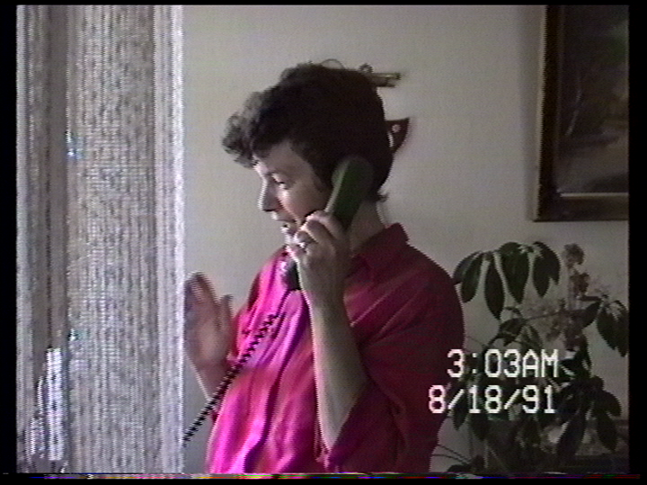

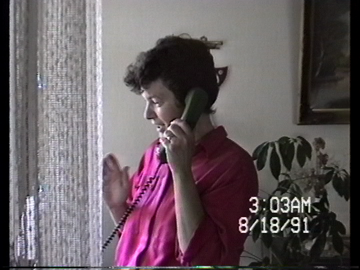

    It seems that FCPX previews DV and ProRes differently. I compared both Videos in VLC and the Capture over S-Video is better than over DV! Colors are better (i think that is due to the way color is done on NTSC and DV is not optimal for NTSC)
    attached are the screenshots. I will provide Video samples as soon as i am done recapturing all 6 tapes over s-video (3rd times the charm, eh?)
    Above is DV, below was captured via S-Video, Panasonic DMR-575 -> HDMI -> Blackmagic Intensity Pro -> ProRes422

    If you mean lossless in the sense of compression, no. Your miniDV camera will compress 5:1 and use 4:1:1 chroma subsampling. An ADVC will do the same thing. It seemed from the last page you already understood this.
    So you're not capturing PAL? Any idea why the bottom shot is vertically masked and resized?
    no, i am capturing ntsc because the tapes i have are ntsc. I am curious about the masking aswell, i will try to find out why it does that. I used blackmagic media express to capture from the intensity pro. (and put all on ntsc / sd / interlaced)
    EDIT: It seems that analog capture of NTSC VHS/Hi8 etc. wants 720x486, DV NTSC / DVD is always 720x480 or so i understood.
    Here is a link on that topic: http://forum.grassvalley.com/forum/showthread.php?t=25015
    or just google for "ntsc 480 / 486", lots of hits.
