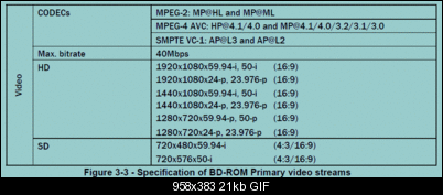

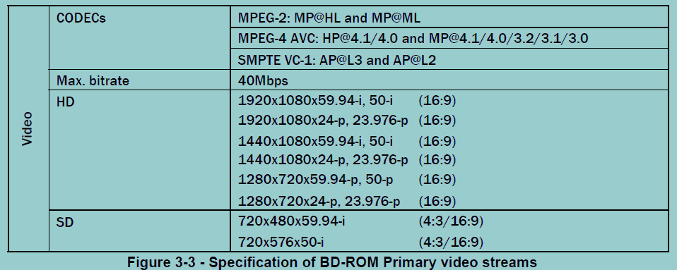

  8. 1440x1080 anamorphic Blu-Ray is allowed, not that I ever done it, but it is in the specs.
  9. @_Al_: are you sure? As far as I know 1440x1080 is only allowed for AVCHD not Blu-ray.
  10. Member Cornucopia's Avatar
    It's allowed on BD also (for 2D).
    From the BD spec tech paper (put out by BD forum members):

  11. Ah, okay. Thanks for clearing that up.
  12. Hmmmmmm...... I've never seen a 1440x1080 Bluray, so I simply took Wikipedia's word for it, which labels the 1440x1080 Bluray spec as 4:3, which makes it square-pixelled. According to the chart Cornucopia posted, I guess Wikipedia is wrong, and this pdf seems to confirm the wrongness.
    Another article here which seems to indicate Wikipedia is wrong. So I guess I stand corrected and it's possible for a Bluray video to be anamorphic, although I'm sure I've never seen one.

  13. Member Cornucopia's Avatar
    No, it's anamorphic like HDV where the PAR is 4:3, making the DAR 16:9. Basically, directly supporting HDV resolutions (for obvious reasons, since that's where some of the source material would have come from). Yes, the wiki needs to be fixed.

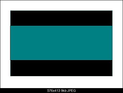

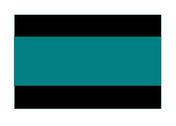

    You can have a 2.40:1 aspect ratio because the 2.40:1 video is encoded with black bars added. The video aspect ratio plus the black bars gives you a total resolution of 1920x1080 and aspect ratio of 16:9. If you removed the black bars the remaining picture would consist of 1920x800 worth of square pixels.
    Without trying to be to scale......
    Green plus black = 1920x1080 or 16:9.
    Green on it's own is 2.40:1
    So for wider than 16:9 images, some of the resolution is nothing but black (for wider than 16:9 video, you could look at it as the video being reduced in size until it fits inside the 1920x1080 frame). That's why if you crop the black bars when encoding, you can be left with resolutions such as 1920x800 etc. It's all square pixels for 1920x1080 Bluray though.

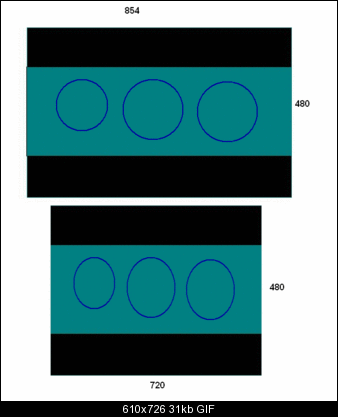

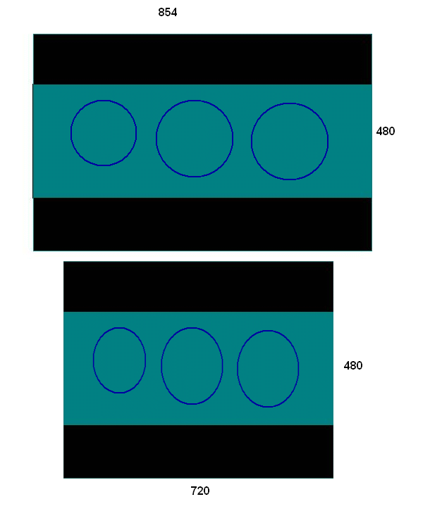

    DVDs work exactly the same way, expect for DVDs the 16:9 picture, which for NTSC would be something like 854x480 (16:9), is squished down to 720x480. On playback, it's resized back to 854x480 to display correctly.
    For DVD video, it might start out looking like the first pic below (854x480, which is 16:9) but it's resized to 720x480 (bottom pic) for encoding. On playback it's resized to the same dimensions as the top pic again to display correctly. That's what makes DVDs anamorphic.
    DVDs can contain a 16:9 picture, or like the example below, they can have a 2.40:1 picture inside the 16:9 frame, with black bars top and bottom.

    DVDs work exactly the same way, expect for DVDs the 16:9 picture, which for NTSC would be something like 854x480, is squished down to 720x480. On playback, it's resized back to 854x480 to display correctly. That's what makes it anamorphic. The picture can be 16:9 or it can be wider than 16:9 with black bars top and bottom. It's anamorphic either way because once it's squished down to 720x480 it no longer uses square pixels.
    So the DVD uses a Storage Aspect Ratio that is not square? The hardware or software player has to convert what is stored into square pixels?

    Storage aspect ratio = resolution. It's the same as the display aspect ratio if the pixels are square.
    I added a new pic to my previous post which might make the way DVDs work a bit clearer.
