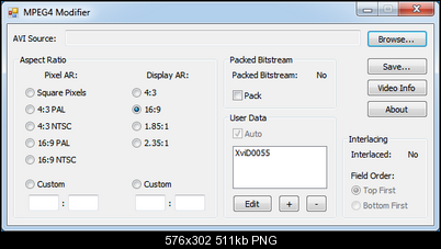

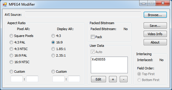

    If your video is already Divx or Xvid AVI use Mpeg4Modifier to remux with whatever Display Aspect Ratio (the final shape of the picture) or Pixel Aspect Ratio (the shape of individual pixels):
    Browse to the video, set the Display AR to 16:9, Save.
