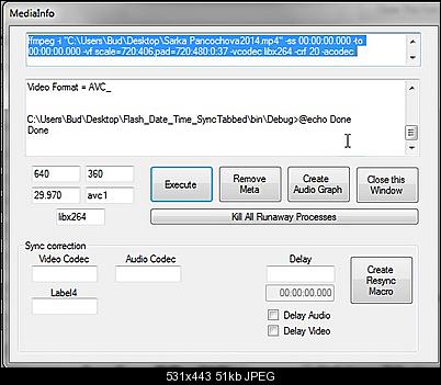

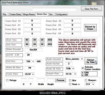

    For videos as you mentioned, that I do not mind the size and quality so much, I use one I wrote that is for trimming but will do whole movie if you leave the times 000. It uses FFMpeg and has defaults that can be changed to others in FFmpeg. It copies what I want or the whole video in whatever format the original was unless the box is checked in the lower right to force it to a format. It's a work in progress so far but it hasn't failed me yet. Quality is adjusted as qscale or CRF depending on the codec. It pulls info on original file and pads and crops to keep aspect correct for whatever you put in the resolution. If the video is 640x480 and you want 720x480, you are going to get pillar bars since it's already 480. It creates the script in a pseudo dos window and lets you change or add if you are familiar with FFMpeg.
    Sound like what you were trying to do?
    ADDED INFO : BTW.. the cursor location is to assist in using the delogo settings.
