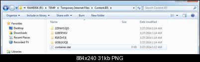

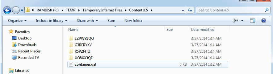

  3. In the Temporary Internet Files folder there is a hidden folder named Content.IE5. That folder doesn't show up in Explorer even if you have it set to show hidden and system files. When you're at Temporary Internet Files in Explorer you can manually add Content.IE5 in the address bar to access that folder. You can also see the files and get there via the CLI.
    And yes, some sites split videos up into little pieces so you will often see many small files, not just one big video file.
