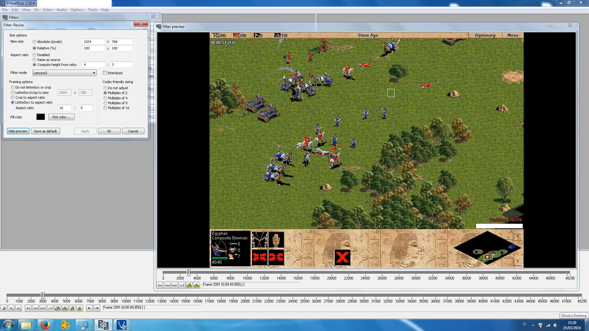

    So I am trying to resize the video using VirtualDub before uploading.
    -I installed the x264vfw codec
    -I used this rule as filter: https://forum.videohelp.com/images/imgfiles/HfQ9PHC.png
    -I left untouched any other option, except the compress codec (i selected the x264vfw codec).

  4. Some players don't like h.264 in AVI. Otherwise it sounds like what you did in VirtualDub is ok. I'd try resizing to 960x720 and adding borders to fill out a 1280x720 frame. That way you have control over the resizing filter.
  5. To prevent YouTube resizing you resize it to 1280x720, and see if it is going to be better. Use 30fps, not 60fps (saving a bit bandwith also), because YouTube will drop frame rate anyway.

    Neither. I'd resize it to 960x720, without the extra padding. YouTube will play it in the correct aspect ratio.
