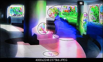

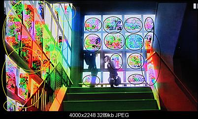

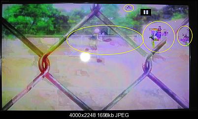

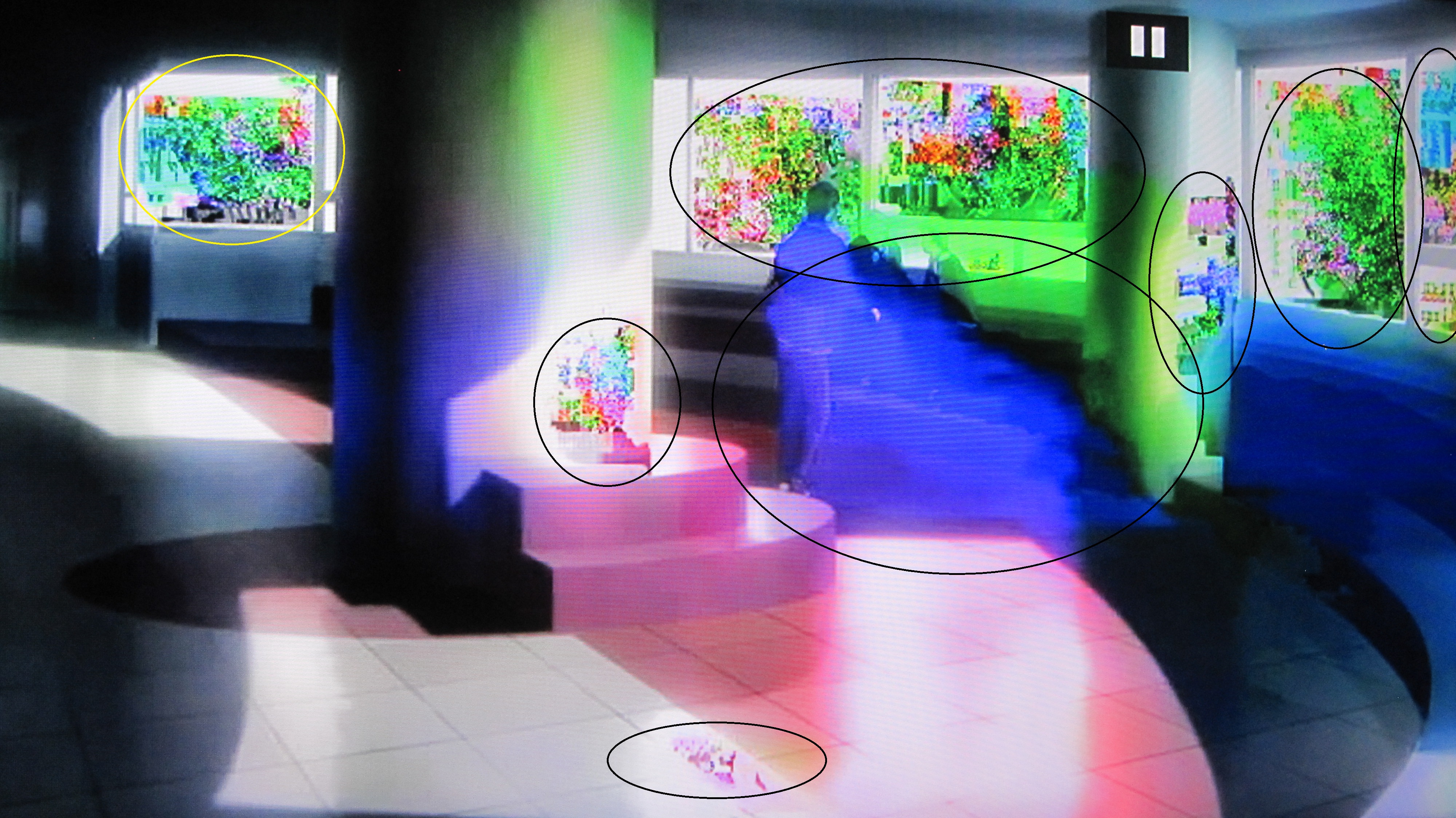

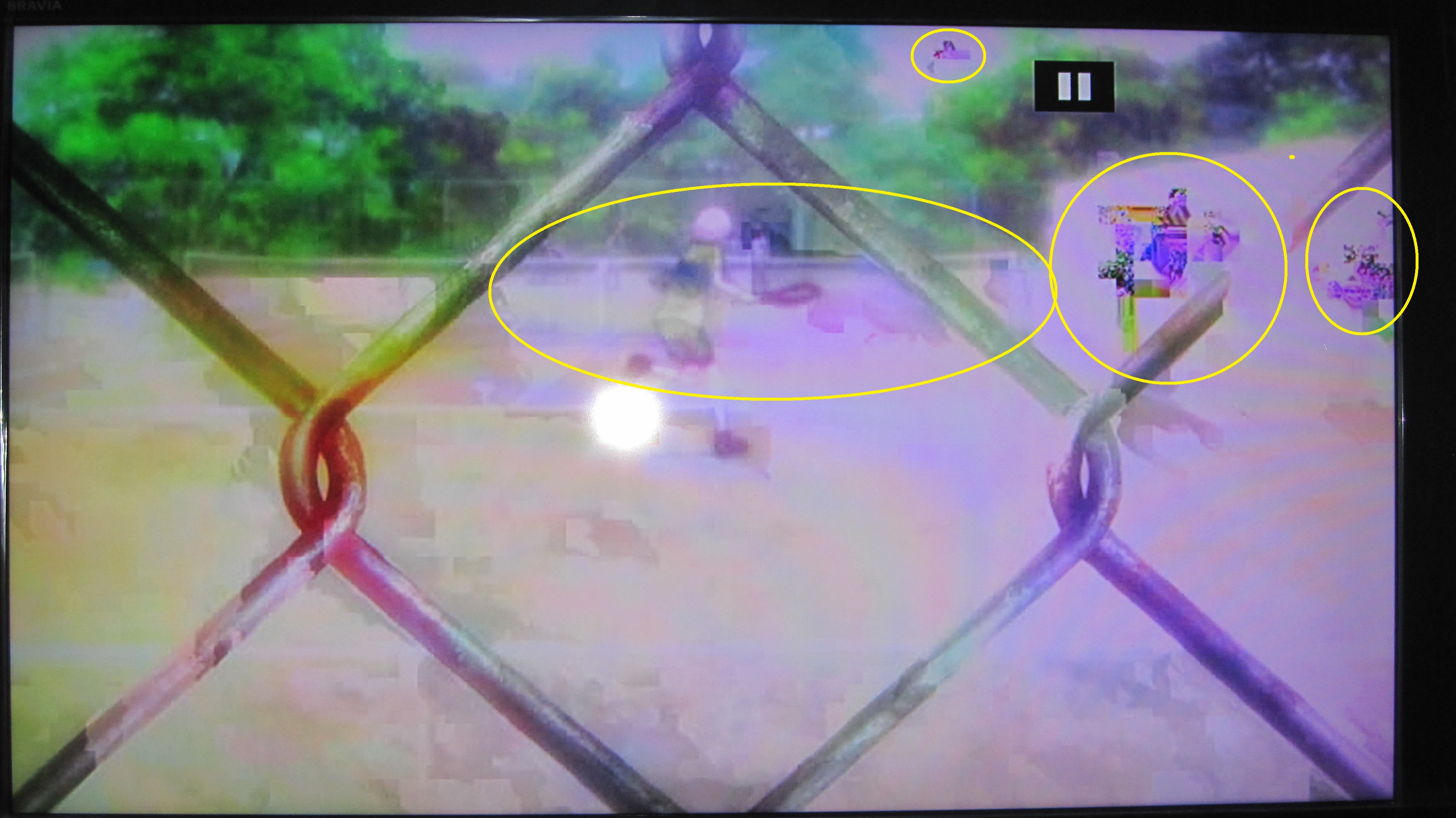

    i'm just finished downloading a blu-ray ripped mkv anime (1280x720_Blu-Ray_FLAC) and burned it to a BLANK DVD. When I watch it on my dvd player. there is a problem shows like these: Click image for larger version

    when I search the problem on the internet, it says that the problem is :"color depth problem" or "video codec problem" is this the correct TERM?
    what should I do to repair this kind of problem?? I REALLY NEED YOUR EXPERT HELP. THANK YOU!!

    Does it look like that BEFORE you convert it to standard dvd? I would guess something is wrong with convertxtodvd. Try another dvd converter like avstodvd, freemake video converter, etc.

    before I burn it to dvd I watched the first episode on my laptop but there is no problem. when i watched it on my PC, some scenes have video problem especially when video change angle or fast motion scene but return back to normal after a few seconds.
    when i burn it to dvd the result became worse as shown in the attachment i posted above.

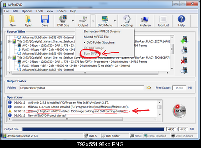

    sir, i tried the FREEMAKE VIDEO CONVERTER the color depth problem is gone BUT the video quality became LOW and there is an enlargement of the subtitle text compared before. And as for the AVSTODVD program,I can't even burn the video's in it. It says that DVD burning is disabled.

    donīt download 10bit h264 movies if u plan to watch them on a dvd player, most 10bit rips are anime movies
  6. so this is a 10bit anime video? i can't identify whether it's a 10bit or not because it does not show in the file name.
    Mar 2012
    Argentina
    mediainfo can show u that info... but even if itsnīt a 10bit encode, it may have h264/x264 parameters that arenīt campatible with your dvdplayer, so u could use the video converters/transcoders pointed out before my post, there is lot of those in here
    I really want to solve this video problem.
    It looks like it uses ImgBurn for the burning part of the process. Just download and install it.
    If you've use AVStoDVD to conver the video and the DVD files it's created are on your hard drive somewhere, ImgBurn should still be able to open them and burn them for you.

  10. thanks.
    i will try this program.
    so after the imgburn program will be installed, can this program automatically connect to avstodvd and I will be able to click the "BURN DVD" button?
  11. Yes, you will.
