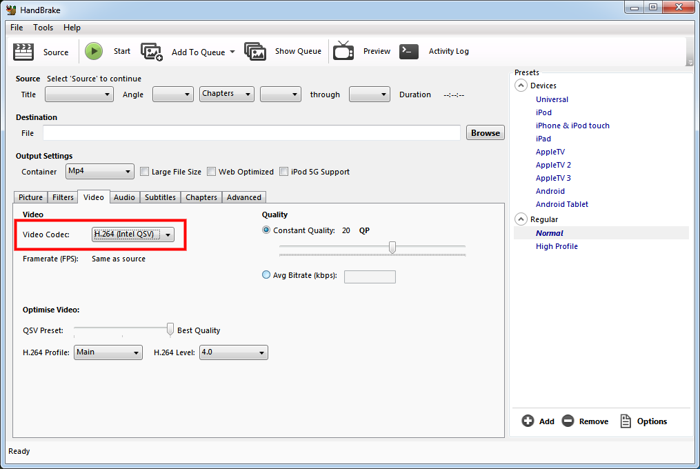

  5. There is a special QS beta build of Handbrake. The cropping feature is borked though. And QS encoding quality isn't as good as x264. x264 at veryfast delivers better quality and isn't too much slower.
    Looking at the changelog it appears QSV is now in the regular builds:
    https://trac.handbrake.fr/timeline
    So maybe they've fixed the cropping bug.
