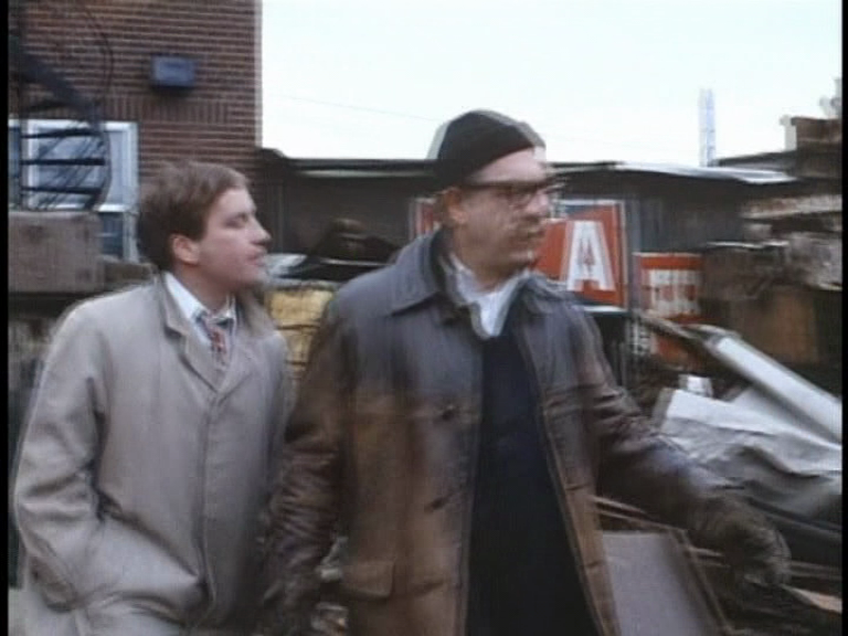

    I bought the DVD of the Italian version of "The apprenticeship of Duddy Kravitz", and the movie looks horrible, as there's some serious ghosting.
    For example:
    VTS_01_2_005.MPG
    VTS_01_2_003.MPG
    I'm a total newbie with AviSynth (and kinda newbie with video editing/encoding in general) so without knowing much I was wondering if there's a way to fix this problem by ripping the movie.
    I tried to look at some solutions proposed here... so now at least I think the problem is the deinterlacing method they used, but how to improve the quality is still a bit confusing
    What would you suggest?

    But this is what you get after a blend-deinterlace. Two different images are permanently fused together:
    Now, with this kind of simple motion it might seem easy to recover the original images. But with actual video, it would be more like trying to separate red and blue when all the frames are purple
    If you have another source which is not blended together, it's probably worthwhile to go with that, even if it means more work in other respects.
  3. The usual NTSC/PAL conversion field blending can be fixed with Yafid(mode=1).SRestore() in AviSynth. But your video has much more blending than that. I don't think there's any way for you to fix it.
