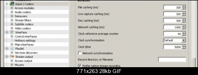

  6. Originally Posted by Hoser Rob View Post
    One of the things I don't like about vlc is actually the fact that you don't have local file cache settings since 2.0 came out.
    Hello!!!
    I must have pointed this out at least a dozen times, yet you keep repeating the same disinformation.
    VLC 2.1.2:
