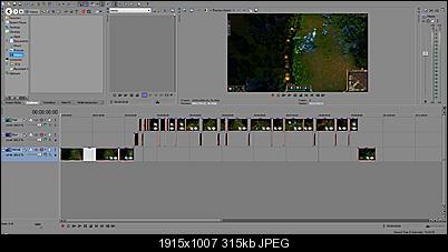

  4. Man I really thought it'd be more simple than this. I tried editing each event individually but the difference in play back rates of each clip is pretty jarring. I also tried grouping the clips together and ctrl-dragging them to speed them up and it works but it only lets me go so far (like up to 4.0 i think) and I need to go to like 18 lol on top of that it moves the clips on the timeline unaligning them with the slow clips and overlapping them.
    Basically what I'm doing is making a montage of kills from League of Legends (as an excuse to learn how to do this) where in each of the clips leading up to the kill plays very quickly to the Benny Hill sound effect and then just for a few frames that is the killing blow slows down then speeds up again so it ends up like this
    fast|slow|fast|slow|fast|slow|fast|slow|fast|slow| fast

    Is there no way to do this in a batch action? or at least some way to maintain consistency of speed? I'm just trying to increase the playback rate of the top track, and decrease the rate of the middle track without screwing up the positioning

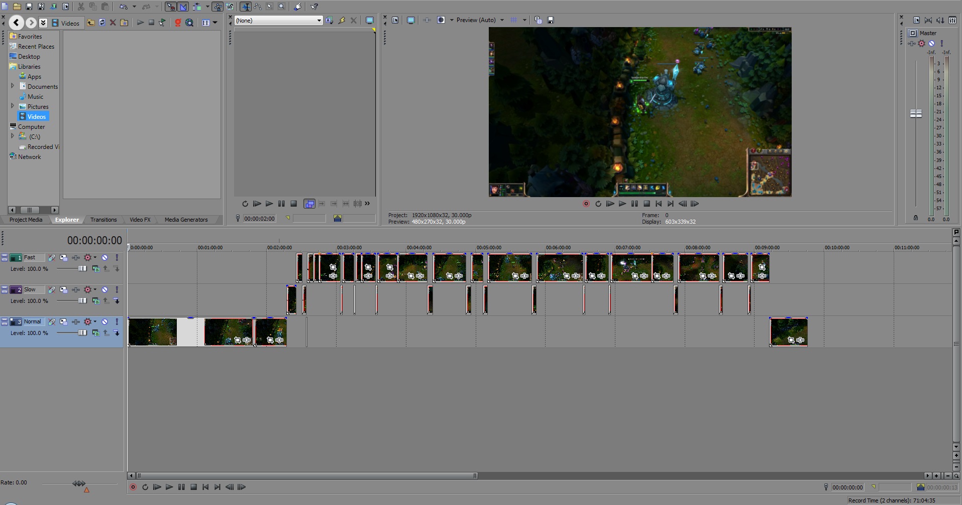

    I'm working on the timing and stuff but i think I've got the hang of it for now this is a chunk of the video I'm working on
