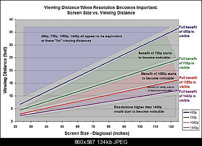

    So try a test 1080p CRF20 encode and see if that's acceptable. I find it to be good enough on a 70" Sharp at a viewing distance of 8 feet. At your viewing distance 720p would be fine, but you won't own that TV forever, and will get a bigger one someday, yes? You don't want to do everything over again when that day comes.
    [EDIT] To clarify, view that test encode at ~ 6 feet viewing distance to see if that's acceptable. At my viewing distance/TV size, I have to look awfully hard to tell the difference between CRF18 and CRF20. Normal viewing, not pixel-peeping.

    MPC-HC lets you choose a resizer in it's settings. There's a difference between a soft resizer and a sharper one when viewing 720p video fullscreen. I think most TVs/Bluray players use a fairly sharp resizer but they're not necessarily the same. My Samsung TV's internal upscaling looks a little sharper to me than my Sony Bluray player's upscaling. Once again the difference is probably something you'd not see back at normal viewing distance although the sharpness of the resizer may have a slight effect on the graph fritzi93 posted above.
