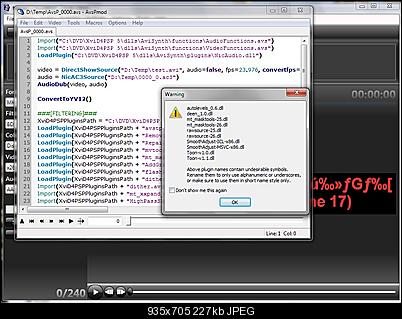

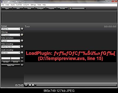

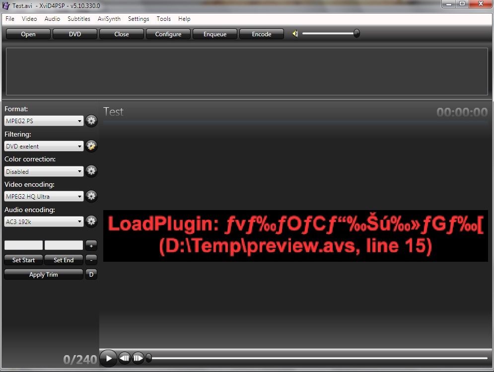

    I'm trying out version 5.10.330.0 and the program runs and converts fine as long as I don't want to use any filters.
    When I try one, I get a weird error on virtually every one. The only thing that changes from one filter to another is
    the line number. Apparently it can't load some dll's like fft3dfilter.dll, mt_masktools-26.dll, and dfttest.dll. I've
    reinstalled and it didn't help.

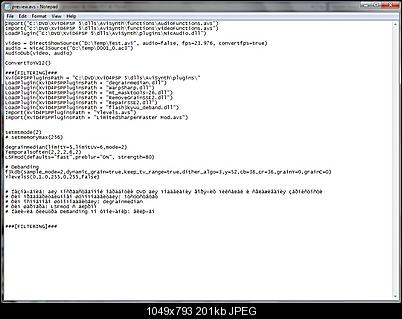

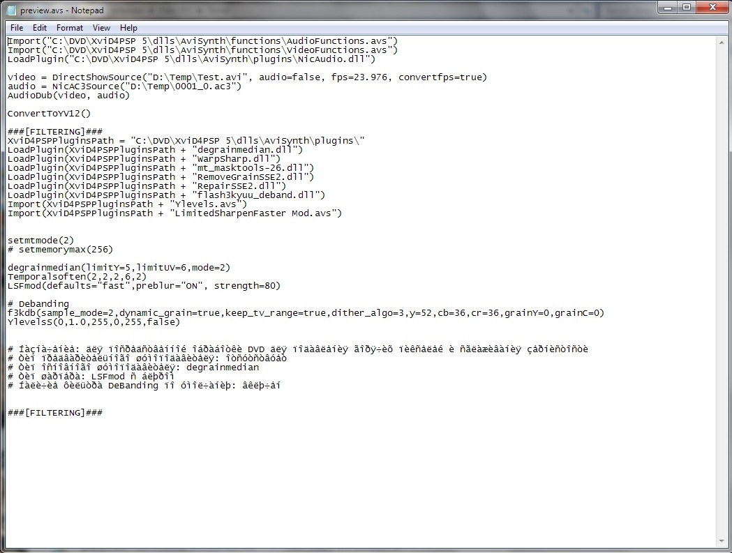

    This is the filtering script it produces.

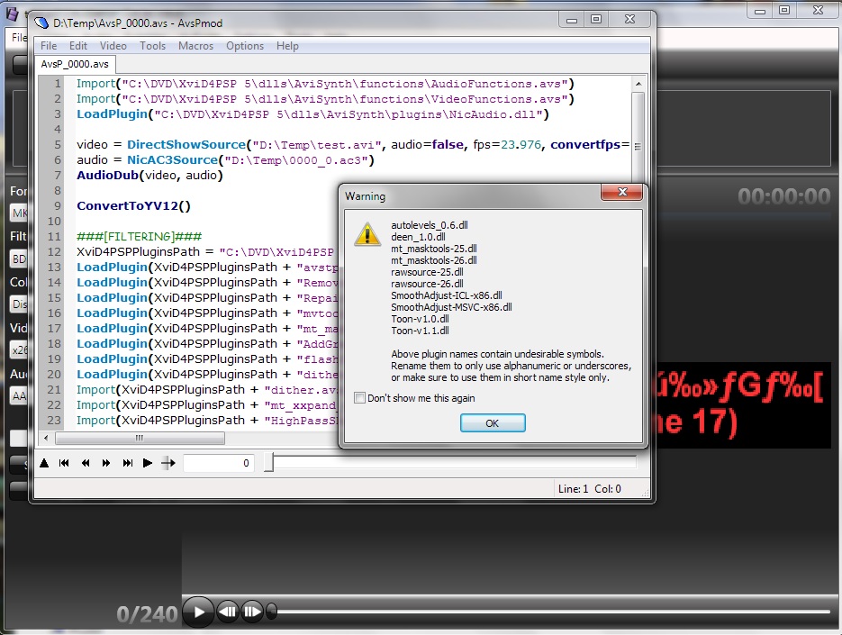

    And this is what AvsP editor says.
    I am no avisynth pro, but do these errors mean anything to anybody??

    Did u try changing the symbols of the plugins for e.g changing mt_masktools-26.dll to mt_masktools_26.dll

    I had tried that before and just tried it again. Didn't make any difference. The avisynth script still references the
    plugin as mt_masktools-26.dll. I don't know how the program generates these scripts internally so I don't know
    how to modify that part to match up. But thanks for the suggestion..... I may be the only person in the world
    that can't run this program.
