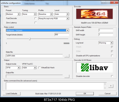

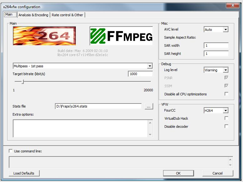

    I'm trying to configure my x264vfw compression in VD but all the guides i came across on the web are for a different version of x264vfw then i have.
    1. I have tried to download from the guides page
    2. I have tried to remove all compression applications from my PC and install only from the guide page
    Noting helped, i keep coming to another version, please see attached pic

    in case that my version in newer- where are all the other options?
    Thanks!!!

    Looks like they stuffed the content of three tabs in the old codec (May 2009) into one flat dialog in the current (March 2013).
    The only way to have access to all encoder options is not to use a VfW codec, but a standalone x264 encoder.
    The AVI container can't handle the advanced features of AVC video anyway (e.g. B-frames with multiple references, or references across I frames; can't separate I and IDR frames).

    The most important change since 2009 was the introduction of the Preset + Tuning system. It's much easier now than ever before.
    • Select a "Preset", depending on how much time you are willing to spend/waste. General recommendation: Not much slower than "slow".
    • If you have a special kind of video material, select a "Tuning" which matches that (usual grain: "film"; as heavy as in 300: "grain"; clean CG: "animation"; not certain: none)
    I will refuse to recommend any values for any other option. I do not even recommend using x264vfw at all.
