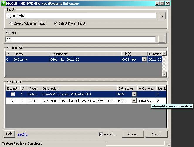

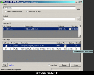

    Here's the HD Streams Extractor opening and downmixing the audio in an MKV. I'm using the version built into MeGUI but it works the same as the standalone version.
    The audio happens to be AC3 in this case and I've elected to convert it to FLAC. I've typed "-downStereo -normalize" into the option section (without the quotes, so the HD streams extractor will downmix and then increase the volume to maximum.
    The HD Extractor will only extract and convert. If you want to convert already extracted audio you could try TAudioConverter, although it should also be able to downmix to stereo and it'll also extract the audio from video files for you so there's no need to do it manually.

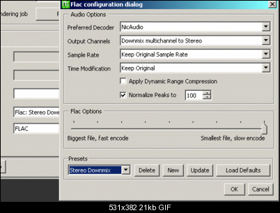

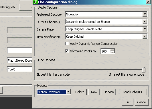

    Or if you happen to have MeGUI installed you can load all sort of audio files (and some video) into it's audio section, pic an audio encoder and then configure it to downmix to stereo.

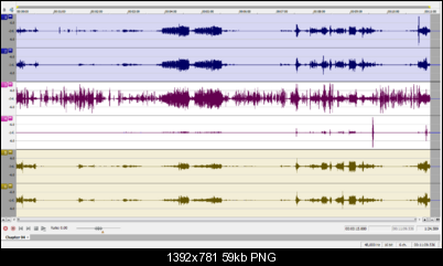

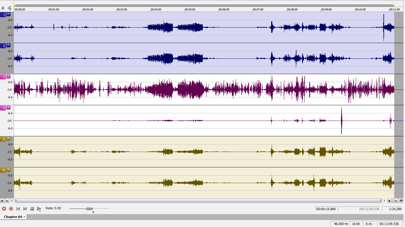

    So, should I work on my editing using mono or multichannel? Since it is already been mixed like you said, it is like removing an ingredient from cake batter after mixing it. For example, the 4 selected channels in the picture when played, there isn't much SFX and vocals where as the 3rd channel is where most SFX and dialog are placed. If I just use the 4/5 tracks (excluding 3rd channel) I might will lose some music as well. So I'm not sure if I should extract the audio to 6 individual mono wave and edit them one by one.

  12. Member Cornucopia's Avatar
    There is no RULE. You have to try ALL options, play with it, and find the best one that works for your target outcome. And this changes every title you work with. It's all manual skill & understanding from here on out. Which is why I said it would be difficult (and painstaking and time-intensive and probably expensive...), even for the best of us.
