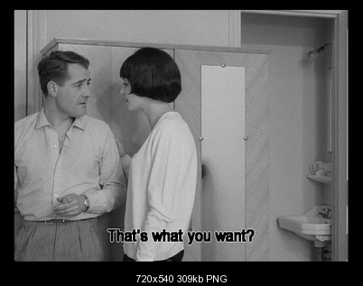

  6. Thanks, videoburger. The palettes helped. Now they're legible but for some reason the interior of the font is still black. Here's the result, regardless of which palette I choose. Not sure what I'm doing wrong.
