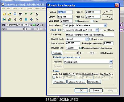

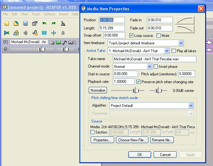

  9. Member hech54's Avatar
    Jul 2001
    Yank in Europe
    Reaper settings:
