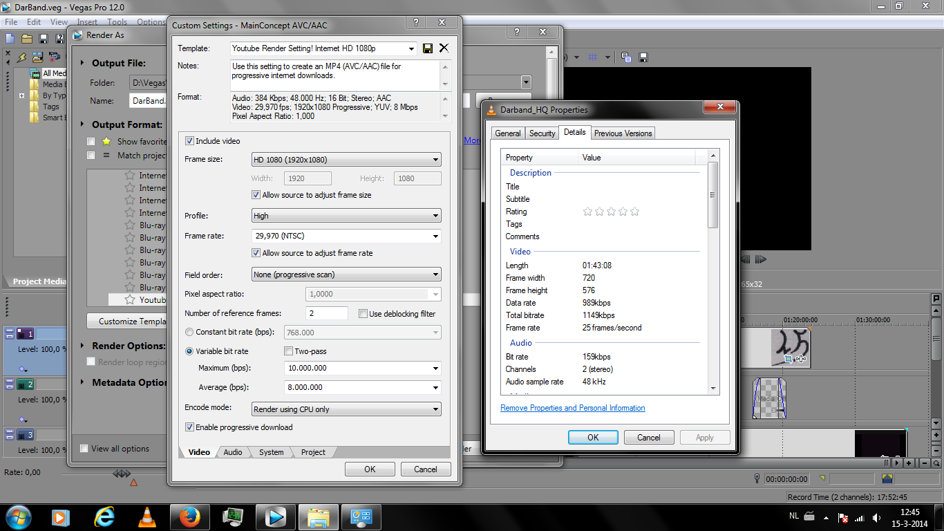

    I downloaded a movie and want to upload it on YouTube. But before I do so, I always want to add my logo and information so I use Vegas12 pro to do that.
    Now here comes the problem/obstacle:
    I want to manually adjust the rendering settings for the video's.
    But I don't know what is best and what to make of the information in the properties details of the original vid as well as the info in the render settings...

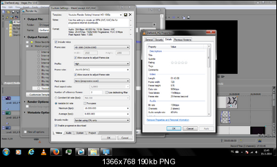

    On the video I hit properties, and then I see this:
Name:	Printscreen - how to render.png

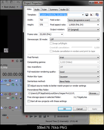

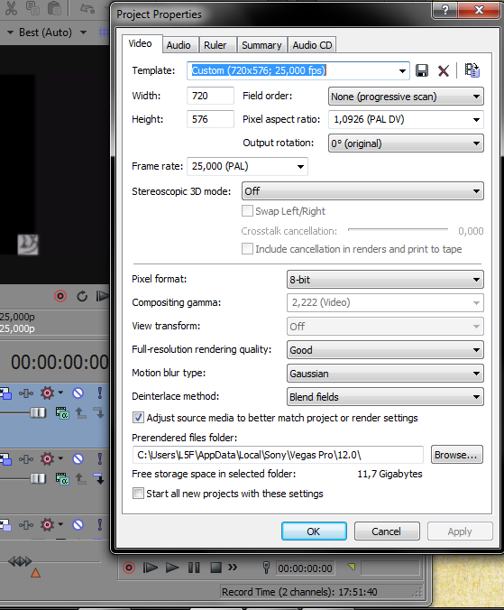

Name:	project properties.png
    Now by rendering this video
    1. I don't want to loose any/much quality on the 700MB video, but I don't want to unnecessarily overdo it too. Because I've learned that it can take a lot of time and space and won't make any difference to the quality of the rendered result.

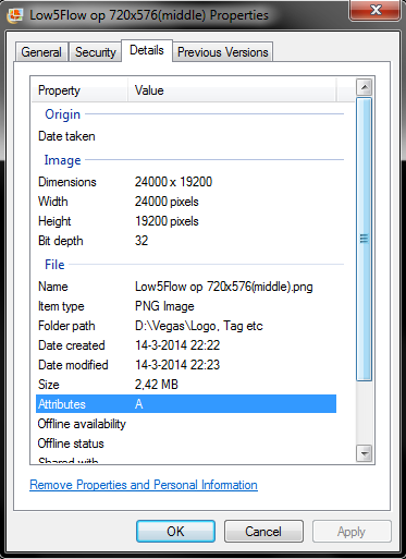

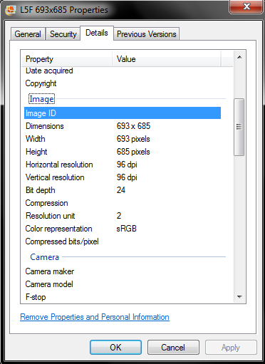

    2. I would like for the logo I have created not to pix-elate like it always does.
    these logo's are for example:

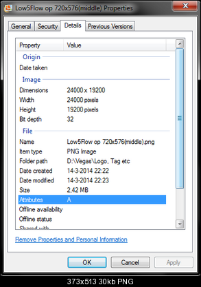

    .jpg
Name:	Logo properties.png

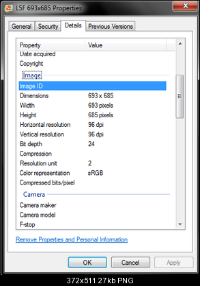

    And
    .png
Name:	Tag properties.png
    Now how should I adjust the settings for this video?? How can I match the properties of the vid to the settings
    It's not a problem to overdo it just a little and wait a little longer for the process or if I get a little larger file.
    But I just don't want to loose quality on the vid and just want the logo and tag to look good...

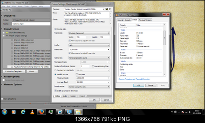

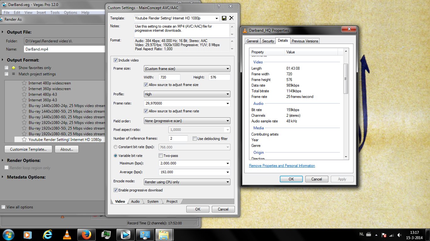

    What about this:
Name:	right or wrong...png
    Am I guessing this right?

  4. 1) Why do you want to put your logo on someone else's movie ?
    2) You need to change the framerate to 25 in the render settings. 29.97 will add blended frames, because the original was 25fps, and your project settings are 25fps
    3) 192kbps for bitrate is going to make the quality very poor. The original used 989kbps for the video bitrate according to VLC . You probably need 2-3Mb/s at least . The higher the bitrate, the less the quality loss, but there will be diminishing returns

  6. You usually want to have a higher max , than average bitrate. This allows "headroom" for bitrate spikes
    So if your average was 2,000,000 , you might use 4,000,000 for max
    Filesize = bitrate * running time. So if the original was about 1,000,000 , the rendered file should be about 2x the size . Each time it's re-encoded with a lossy codec, some quality will be lost . So when you re-encode it , it will lose some, when youtube re-encodes it, it will lose some more.
    You'll probably have another issue with aspect ratio on youtube - because 720x576 is a non square pixel format . (people might look fatter or taller) . It's difficult to give advice with knowing what the DAR (Display Aspect Ratio) of the original was. For example PAL DVD's come as 720x576 but are either 4:3 or 16:9 . They also might have letterboxing or pillarboxing (black bars) , so the content aspect ratio might be something different

    Filesize = bitrate * running time......
    Bitrate >> "total bitrate"?
    Running time >> seconds right?
    This one has pillarboxing indeed!
    Right now I'm a little confused with the Date rate and the Total bitrate.
    I'm trying to work this out before I start asking more questions.
    It's actually the sum of total average bitrates of all streams . You need to add up audio + video + accessory streams (e.g. subs) + container overhead. But for most people audio & video are close enough approximation . If bitrate is expressed as kb/s, then convert running time to s
    Remember to convert between BITS and BYTES (8 bits in 1 byte)
