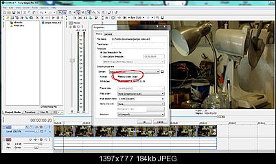

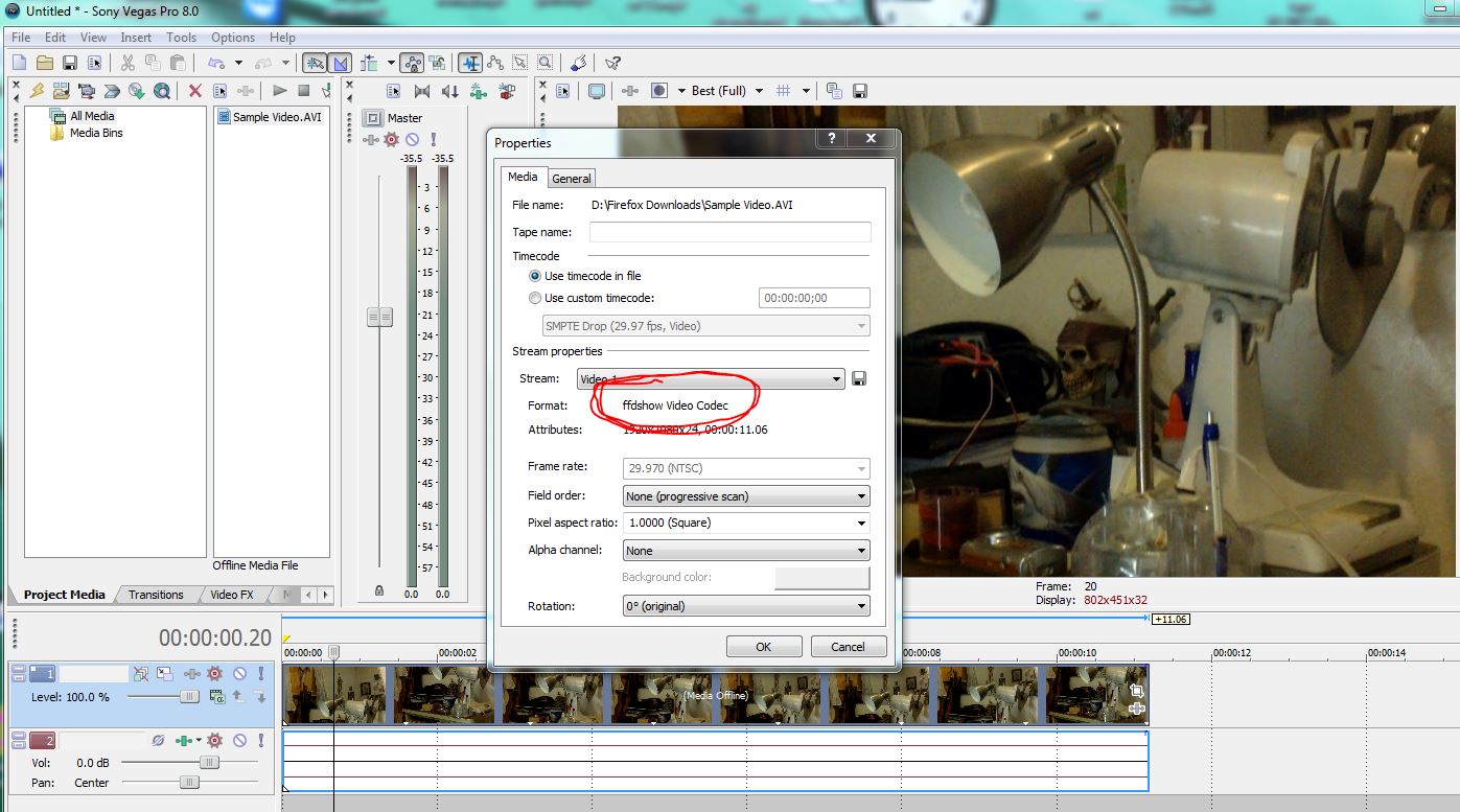

  6. Vegas loaded that video through ffdshow, so you install it and it might be alright to edit, but it needed to be interpreted as progressive, Vegas thinks it is interlace, so in that open window that you can see on picture, select Field Order - "none":
Name:	vegas ffdshow.JPG
    one more thing, you have 64bit Vegas Pro 12, I guess, so you'd need 64bit ffdshow, ..., on that picture I have 32bit Vegas 8 and I have 32bit ffdshow,
    if you have 64bit Vegas installed, 32 bit ffdshow would not work in Vegas ...
