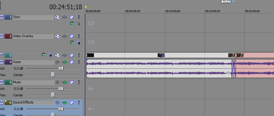

    Thanks. I googled for "sony vegas source window", but didn't find where it is. I attached a screenshot of what I have.
  14. All those thumbnails up on the left. They're in your source window. It's more sensible to use save snapshot to file instead of copy snapshot to clipboard. Notice how a new one appears whenever you make a snapshot. Drag it to your timeline (in your case to the video 3 track) and extend the ends until they match your loop region.

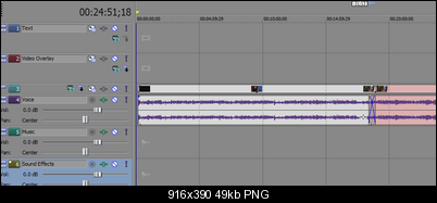

  27. Here is an example of in-sync and out of sync clips.
    Originally Posted by yetanotherlogin View Post
    So it looks like an encoding issue in Vegas.
    Given your demonstrated expertise, I would not yet exclude user error as a possibility.
