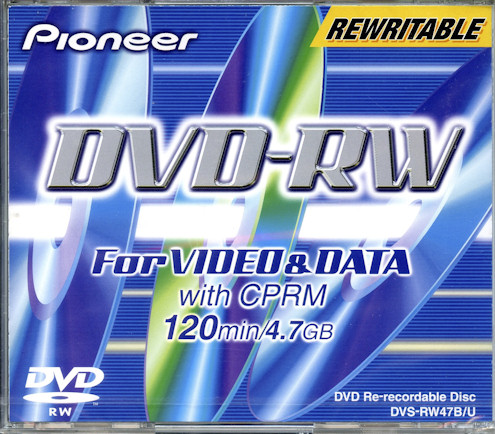

    Then why do I have a Pioneer DVD-RW disc that says "with CPRM" on the front and back of the jewel case?

    https://forum.videohelp.com/attachment.php?attachmentid=24079&stc=1&d=1394739887
    If memory serves, CPRM is a software infection intentionally added to DVD-RW to inhibit copying....
Name:	Pio DVDRW Label 2.jpg
    The DVD recorder applies CPRM, not the DVD itself. The "with CPRM" means that the DVD is CPRM compatible. CPRM compatibility is needed to record content which includes an analog or digital "copy once" flag and thus requires encryption to be used on recordings so that no further copies can be made. If the "copy freely" flag is used on the content instead, CPRM encryption won't be applied to recordings, even if the DVD is CPRM compatible.
    Then why do I have a Verbatim DVD-RW (I just looked at it) that does NOT have a reference to CPRM on it? I have the original packaging and there's no reference to CPRM.
    I think you are misinterpreting what Pioneer is saying. I think they are saying "This disc supports CPRM" rather than "This disc has CPRM on it and NOTHING you can do can remove it, sucka!".
