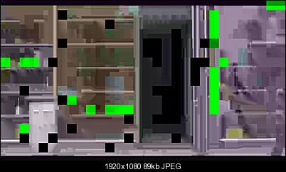

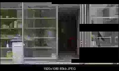

  4. I think TIF only supports 8 and 16 bit depths - at least those are the most commonly used
    If your source is 8bit YUV (and originally 8bit RGB), you should probably use 8bit because your destination is 8bit RGB - unless you are testing 10bit compression formats specifically
    You're going to incur some losses converting between YUV and RGB
    I don't know about the block artifacts, can you post some samples, or provide more details ? Or perhaps they are intrinsic to the settings you used for TApp encoder ? Do they occur on every frame ? What sorts of bitrates were you using ?
  5. Click image for larger version
