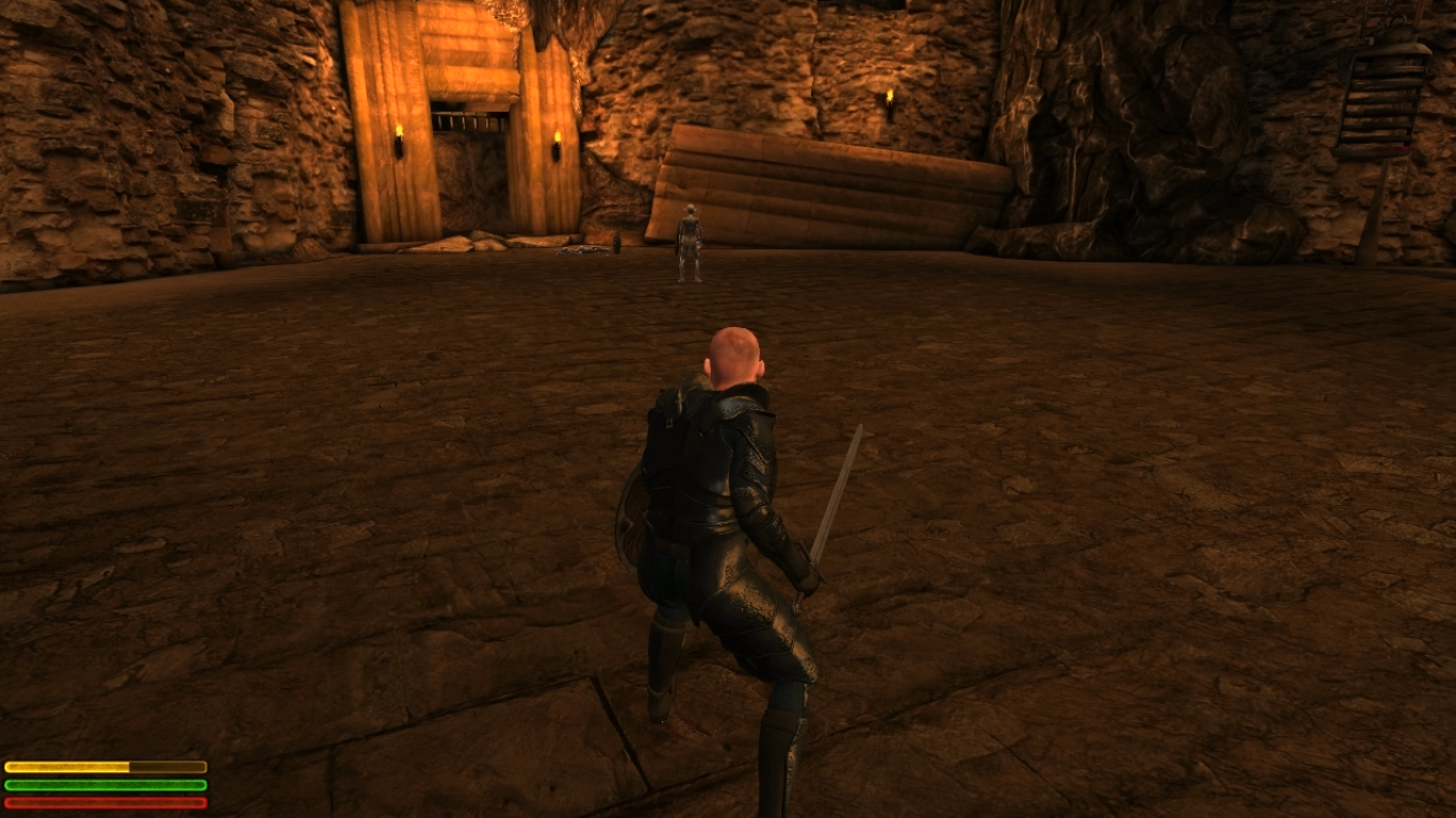

  1. Hello, I'm trying to compress fraps video following this tutorial:
    https://www.youtube.com/watch?v=-Gobx4hcW8E
    except that I used after effects instead of sony vegas

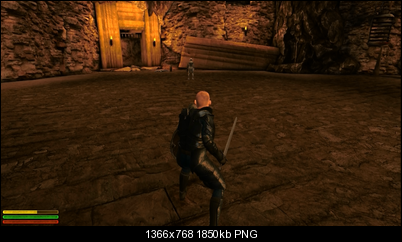

    now problem is that if I play the resulting video of lagarith or the final mkv video with WMP, VLC or MPC then colors are washed out! But with GOM Player and Youtube it looks OK!
    how to fix this so it would play correctly on all players?
    thanks.
    with most players
    with gom player

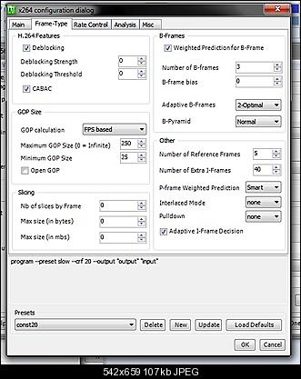

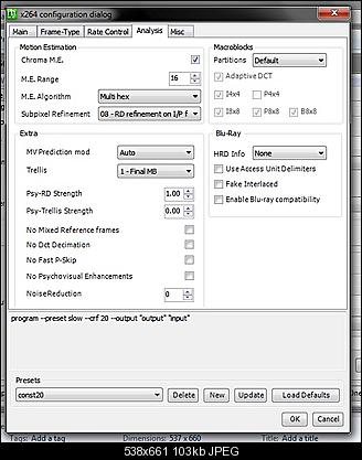

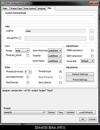

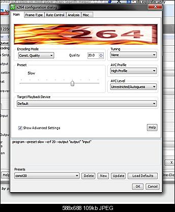

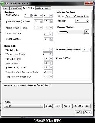

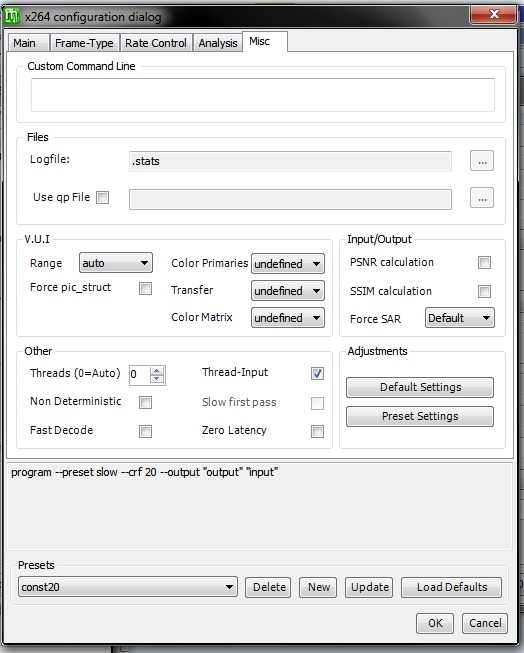

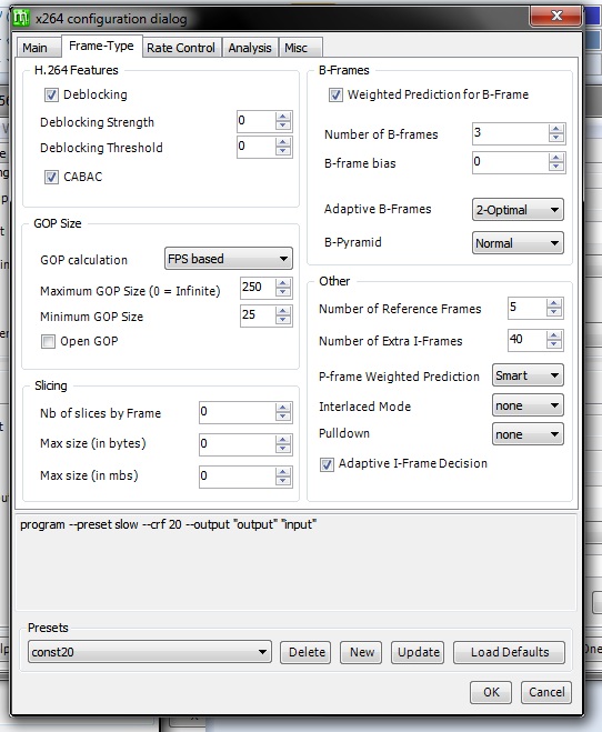

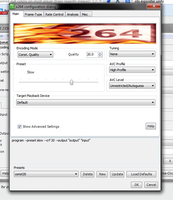

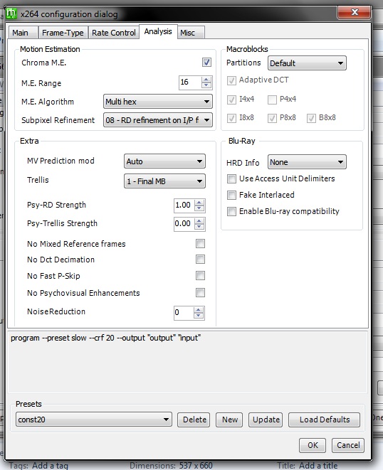

    here are the snapshots
ID:	24056Click image for larger version
ID:	24057Click image for larger version
ID:	24060Click image for larger version
ID:	24058Click image for larger version
    note if I upload the video on YT it looks fine but if I downloaded it and played it with MPC and others it looks washed out again, and that's the heart of the problem, I want my videos to play correctly online and offline.

  9. Last screen V.U.I. try to set quantization Range as Full http://mewiki.project357.com/wiki/X264_Settings#range , color primaries and color matrix as bt709. currently there is no information on this and various players "guessing", beware also of the fact that VUI can be ignored by h.264 decoders (player) and still you can have issue http://mewiki.project357.com/wiki/X264_Settings#Video_Usability_Info . But defining this will give at least some chance to avoid this problem.
    unfortunately this didn't solve the issue, quantization Range has three values: auto, pc, tv
    pc gives the same old result
    tv makes colors a lot darker
