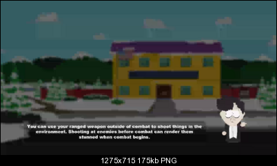

  1. Hey all this is my first post on the site but I really need your guys' help. I'm running fraps, the video is perfect, then I put in the video I want to edit all is well... I also disable resample Here is an image of what happens in some frames (Not all the time) After rendering keep in mind after I'm done recording the actual hard copy of the video it's perfect this just occurs after I render it. Image one: Click image for larger version

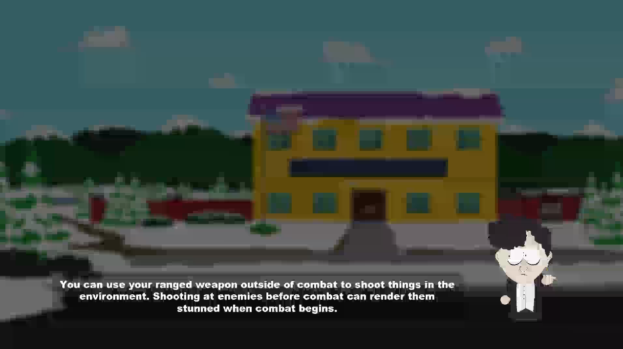

    This is what its suppose to look like (this is the Raw copy before editing: Click image for larger version
Name:	This is what its suppose to look like.png

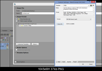

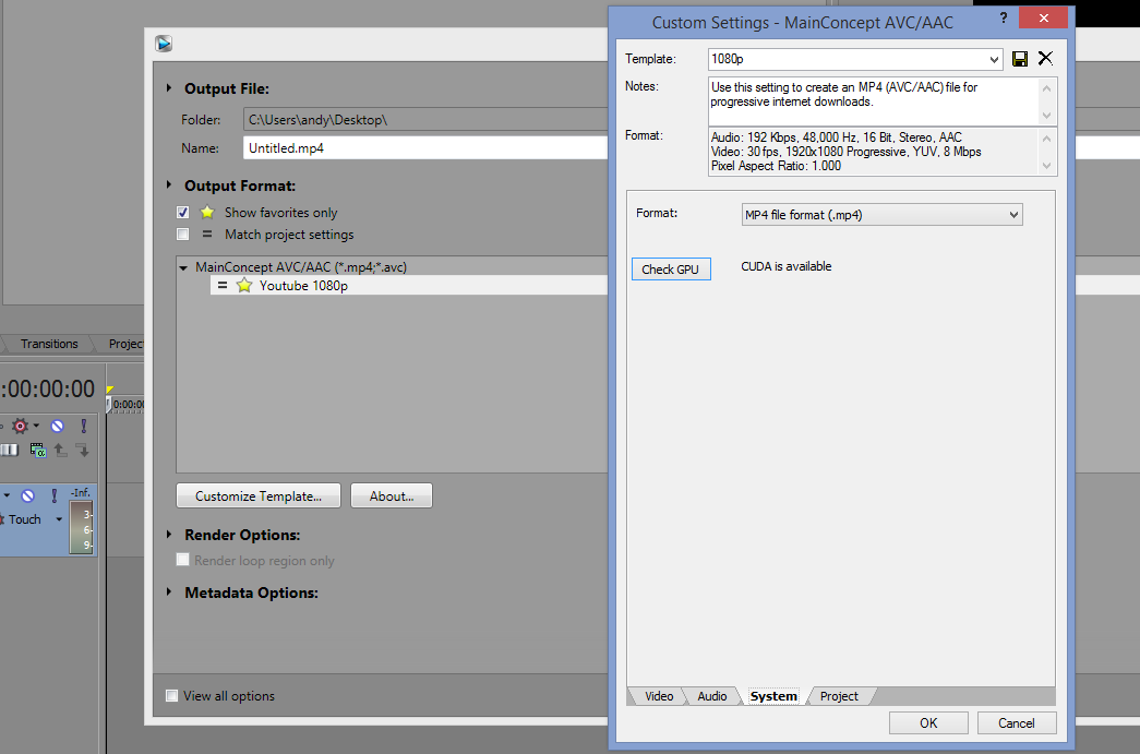

    Here is my render settings from sony vegas: Click image for larger version
Name:	Sony Vegas help 1.png

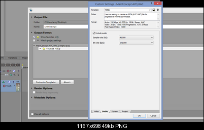

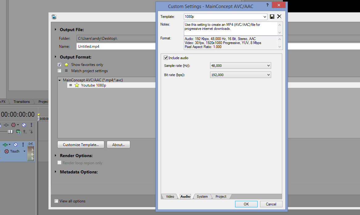

    And here are the render settings: Click image for larger version
Name:	Sony Vegas help 5 Audio settings.png

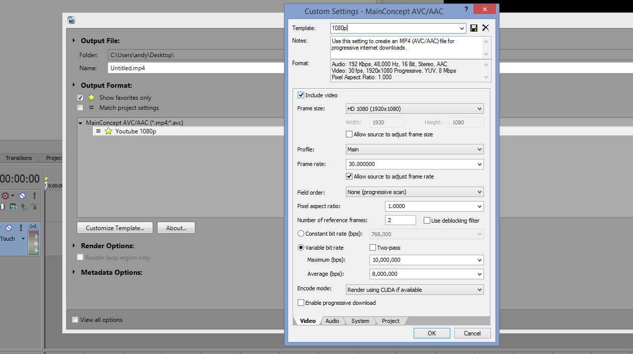

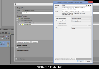

Name:	Sony Vegas help 4 System settings.png

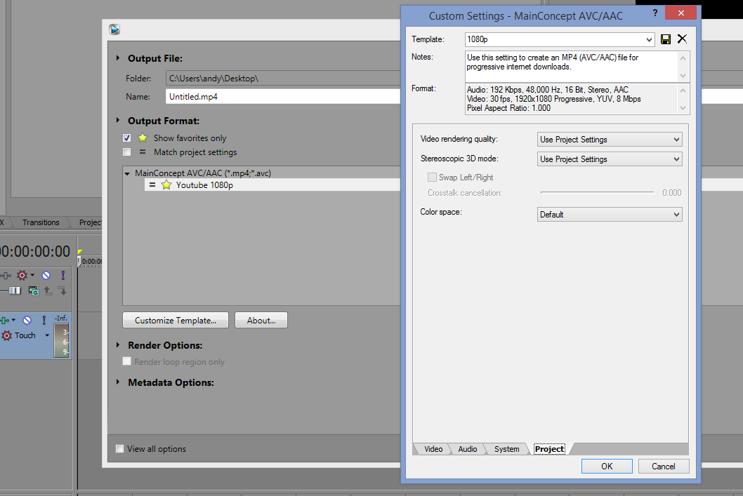

Name:	Sony Vegas help 2.png

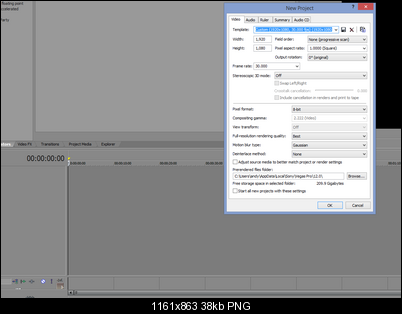

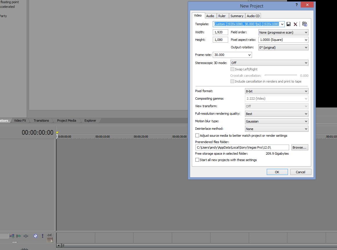

Name:	Sony Vegas help 3 project settings.png

  2. Don't use GPU encoding (disable CUDA).
  3. hey poison, do you think cuda was the problem? man I hope so!!
  4. nope just did a test its still doing it even after disabling cuda *Sigh*
  5. Do you see it in the vegas preview window ? or only on the export ?
    Disable GPU acceleration as well
    Try another compression format, like WMV, or even a lossless codec like ut video . That will help rule out if it's compression that is the issue

    try the following: load your video, file->properties, pixel format 32bit floating point (full range), full resolution rendering quality set to best, motion blur type set to gaussian, deinterlace method set to none (i assume your source is progressive), at the top field order should also be set to progressive, video transform set to none, adjust source media should be unchecked.
    also keep in mind, set slices to 1, any setting that allows the source to change the settings, such as frame rate, disable and any place you see anything that says change source to match render settings disable, also disable enable progressive downloads.
