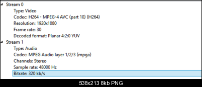

    I would like to convert a lot of AVI files that I get from my Dxtory into MP4. I want to do this because sony vegas plays avi files really slow for some reason. I know that using MyMP4 Box GUI i can first Demux the video and then join the 2 files into an mp4 but that is too much for work and I'll have to do that for about 100 files. Is there a program using which I can just select the avi folder and the output folder and can convert all the avi videos without re-encoding?
    I think converting avi into mp4 does re-encode the audio but I dont mind that. I only want the video to be in a really good quality.
    This is the video codec and stuff from VLC:
    Also, Im sorry if this question has already been asked but I tried to search the forum and did not find any results for my needs.

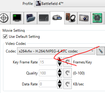

    I found out how to reduce the quality of the video, but I'm not sure about the keyframe and "--tune fastdecode" thing.
    Is this what you want me to change for the keyframe? What should I set it to if I'm planning to store about 15-20 hours of gameplay in a 2 TB HD

  6. I don't use dxtory, but I think you push the button to the right of where it says "codec" to access the x264vfw advanced settings
    Depending on the version of x264vfw you have installed, there might be presets that you select from a dropdown menu, or you might have to enter it on the extra command line options box
    --tune fastdecode is the same as
    --no-cabac --no-deblock --no-weightb --weightp 0
    The smaller the "key frame rate", the less compressed the files will be, and seeking/scrubbing performance in vegas will improve
