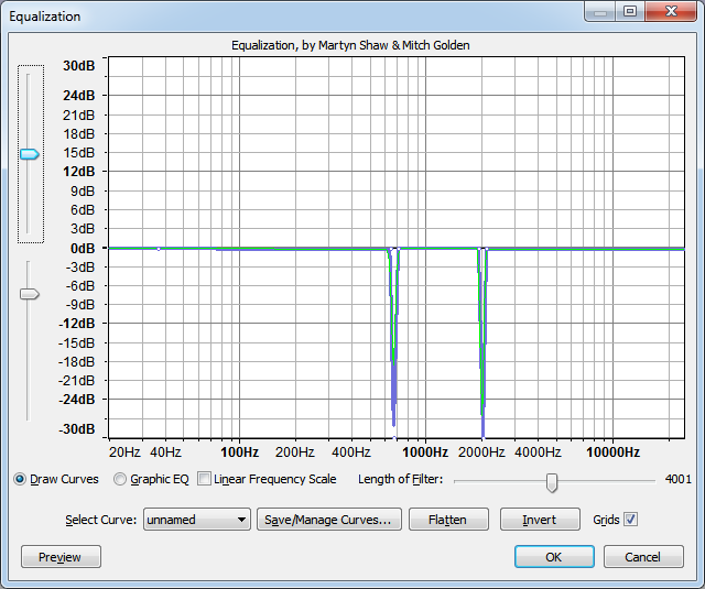

  3. Use a narrow notch filter at 670 Hz and 2000 Hz. Another at 1340 might help too.
    Those are two notches using the equalization filter in Audacity. You can probably more accurately determine the exact frequencies and get even better results using the notch filter.
