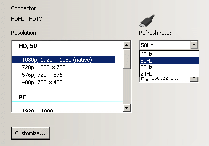

  20. I don't know if you guys read my earlier posts, but the frame rate/refresh rate thing is why I went to the trouble of checking which refresh rates my TV was using when playing different types of video using the Bluray player to play standalone files. Best as I can tell, even though I live in PAL-land and therefore own a TV and Bluray player which are officially "PAL", the only time the Bluray player will switch the TV to 50Hz is when playing a PAL disc (Bluray, DVD etc) or when playing a "PAL" AVCHD folder via USB. For everything else, the TV seems to stay refreshing at 60Hz. I suspect, though I'm not sure I've checked, the TV's built in media player also plays standalone video files with the TV refreshing at 60Hz.
    Therefore, assuming my TV and player are typical, the OP would probably be better off using 30fps.
    I'm using XP so I can't choose between 59.940Hz and 60Hz. I believe later versions of Windows allow you to. I generally leave my TV at 50Hz while using ReClock to play everything at 25fps, which gives me a kind of "PAL film mode". Plus I also have a reasonable amount of interlaced PAL, or 50fps video, but very little interlaced or 29.970 progressive video etc. According to Reclock, when I connect to the TV at 50Hz it's actually connected at 50.002Hz. 60Hz is really 60.002Hz, 25Hz is really 25.001Hz and 24Hz is really 23.951Hz. The timings never seem to be exactly what they should be.

    My other half has an LCD TV which must be 6 or 7 years old. Maybe a bit older. It'll do both 50Hz and 60Hz. I remember when I set it up for her I contemplated whether to configure MPC-HC to switch refresh rates, but decided to go for "low maintenance mode" and left the laptop connecting at 60Hz. I can't remember if her TV supports other (lower) refresh rates, but I think it does.
    My TV supports various refresh rates from 24Hz to 60Hz, depending on the resolution. They're the refresh rates listed in the Nvidia control panel under "TV". A couple of the "PC" resolutions go as high as 75Hz. I've tried them and the TV displays 75Hz when it switches, and the slight "buzz" emitting from the rear of the TV changes pitch according to whether the refresh rate is 60Hz or 75Hz (it's a Plasma), but I've never checked to see if there's some sort of internal conversion going on. I might later, as I'm curious now.....
    But yeah, the TV happily switches refresh rates according to what the Bluray player instructs it to do. The Bluray player also supports Bluray's "film mode" which is far as I'm aware, only applies to 24fps video. There's no 25fps "PAL film mode", as such.
    Actually the TV has a PC/HDMI input. If you connect something to that input at 60Hz it goes into "PC monitor mode". Pretty much the same as when connecting via VGA. It only works like that at 60Hz. Connect something to the same input at 50Hz and it stays in TV mode. I'd bet a lot of PAL TVs would have some sort of PC/HDMI input these days, given VGA support is becoming less common.
    The 576p and 480p resolutions only support 50Hz and 60Hz respectively and at 720p I can only choose either 50Hz or 60Hz. I've never really played around with custom refresh rates much to see what'd work as I leave it at 1080p.
    If I remember correctly my other half also has a 59.940Hz option as she runs Win7, although I kind of remember the TV only refreshed at 59.940Hz even if 60Hz was selected, but I'd need to check. I set hers up a fair while ago.
    Remember PAL and NTSC really only apply to 720x480 and 720x576. When it comes to high definition there is no PAL or NTSC as such. The same could be said for SD video with square pixels (ie AVIs). It's just frame rates, refresh rates and resolution. Viewed on a CRT TV they would need to be converted to PAL or NTSC but not so much any more. 1080p is 1080p no matter where you live.
