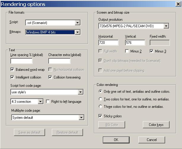

    You sure about that? I just did a test making some PAL SSTs (I'm in NTSC land) and each BMP is 202KB and 720x573. Yours aren't 4-bit and that's the reason the subs aren't being accepted by Muxman. I'll assume he used MaestroSBT to make the subs and the screen where you choose the kind of bitmaps to use should look something like the picture below:
