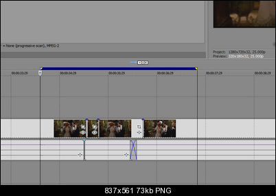

  27. Get Vegas Movie Studio, the $40 one, not the $600 one.
    Import your ripped vobs
    Place them on a timeline
    make sure "ignore event grouping" is selected
    Play down to the offending audio
    place cuts around the parts you want to delete
    delete
    find a nearby piece of background sound that matches the general background
    match frame to the source
    mark in
    edit the clean background into the hole -- or slow mo the audio on the heads or tails to fill
    add dissolves at the cuts if necessary to smooth it out
    Rinse and repeat
    Here, the word "cape" is removed. Note the crowd walla and music sounds continuous.

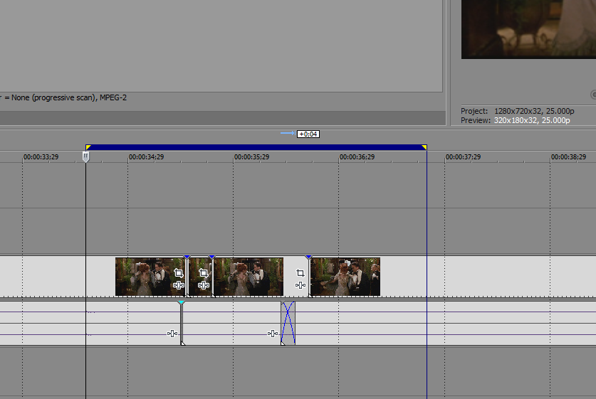

  28. Originally Posted by rixtertrader View Post
    The AUDIO is the most important part for me. 99% of the movies I've seen (PG-13) are not objectionable to me visually, just a word or two. So if I had to chose between a video edit and an audio edit, I would like to AUDIO edit my movies.
    Can we go from there?
    I missed this earlier, sorry.
    The suggestion netmask56 made will certainly work. I'm familiar with Womble's MPEG Video Wizard. (Other editors can do the job too, of course.)
    You can drop the volume anywhere on the sound line for however long is necessary.
    Under Image Filters, there is an image blur filter.
    If you're going to go to the trouble of learning to use Womble, you might as well learn how to blur as well as mute.
    I'm glad you're not deterred, but you have your work cut out.
    Pull! Bang! Darn!
