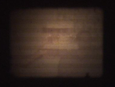

And, although I'm using a plain light grey piece of plastic (about 400microns thick; I think it's called "Mylar"), the recorded image has several thick grey horizontal lines in the image.
I don't have image examples of the 'image bleeding' or 'photograph negative' instances but here's an example of the lines:

Now, about the horizontal lines. There are 2 types of shutters you are dealing with: the mechanical shutter of the projector and the electronic shutter of your camcorder. By varying the projector speed, you solved the mechanical shutter issue (which causes flicker) to some extent, although things can drift off speed incrementally, and you need to be able to override this during the course of the film run. The lines have to do with the electronic shutter in your camcorder. You must manually tweak it until the lines disappear.
I cannot recommend shutter speeds, as you do not list your location, and I have no way of knowing if you are in a PAL or NTSC country. -
